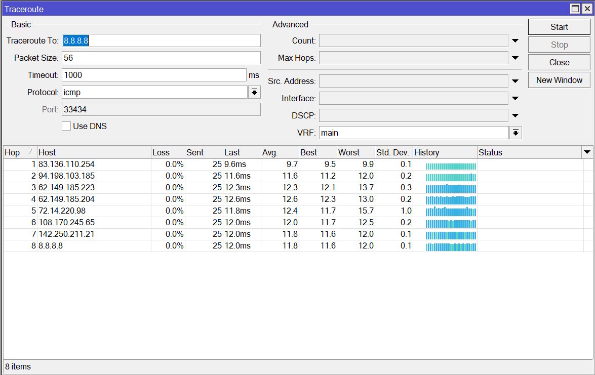

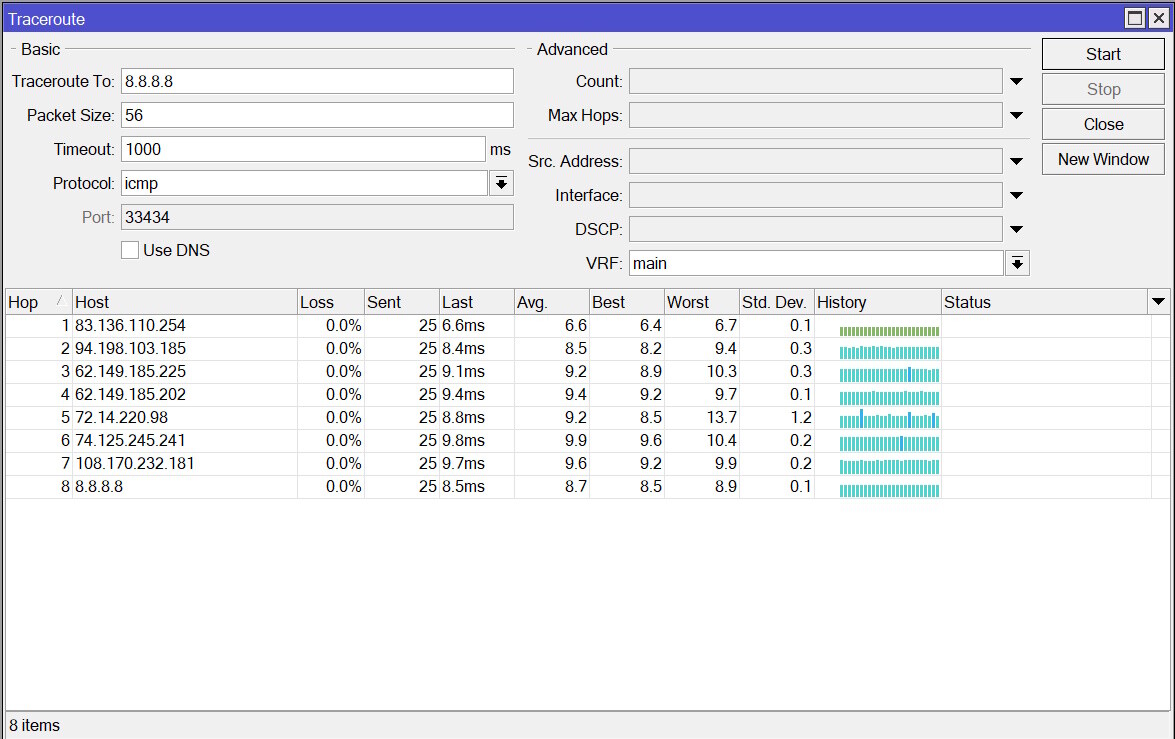

Upgrade from hap ac to 4011 - lost 3ms
I recently upgraded from RB962UiGS to RB4011iGS, the configuration is virtually identical and with the new router i lost 3ms on the first hop.
Clearly this is not a big problem that impacts line utilization but i would like to understand how this is possible.
thanks

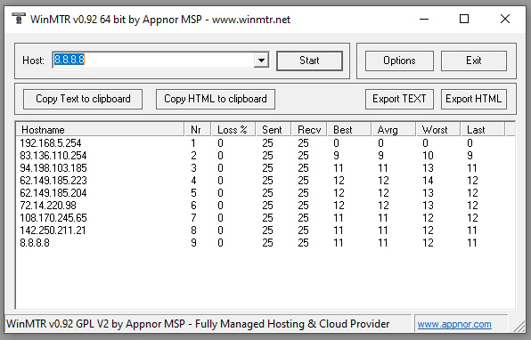

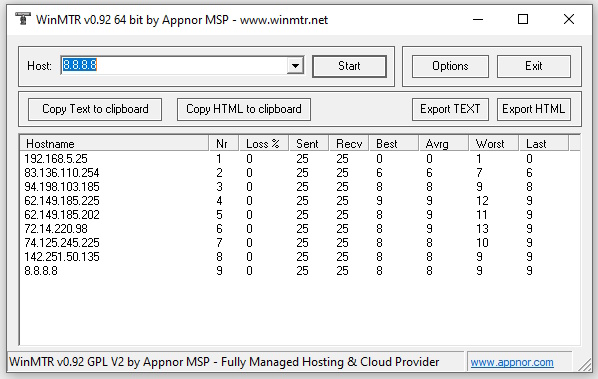

i have the same problem, here are mtr with my pc.
I don’t understand why i lose 3ms to the first hop with a better router.
