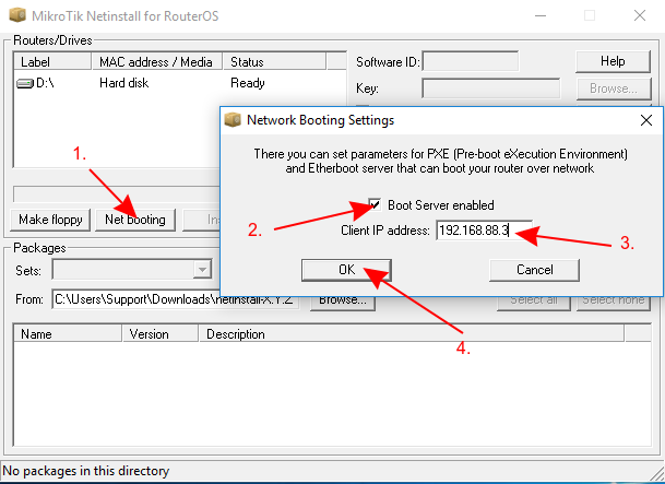

But, my netinstall software can not find my Mirotik even if it is connected to my computer directly (with no switch or router in between)
Now, I have 2 questions:
  1. The ethernet 1 on my Mikrotik is POE and can not assign 192.168.88.1 to itself, should I assign this IP manually to this port?
    I have tried this with ethernet 2 on my Mikrotik but still can not detect it.
  2. Why does that step-by-step manual enter 192.168.88.3 in the Network Booting Setting form when there is no 3rd device connected to the Mikrotik or PC? (See attachment)
because is supposed you set the fixed ip 192.168.88.2 / 255.255.255.0 to the pc
and the 192.168.88.1 is used on default configuration after the routerboard is installed with the new software
fast instructions: disable all other network interfaces on PC (bluetooth, wireless, vm, vpn, etc.)
in the used ethernet set 192.168.88.2 / 255.255.255.0 as IPv4 without gateway or dns
start now netinstall with the settings on picture
press the reset button, keep it pressed, connect power / poe to the ether1
keep reset pressed until you do not see the device on netinstall
select the device and install
If you have some troubles search the anav guide to netinstall on the forum

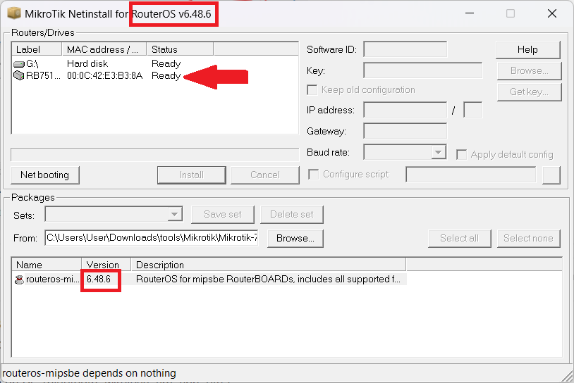

I did those steps as you mentioned and after clicking on install button I got the screenshot state (which got me "Ready" status) but still my Mikrotik version is on v5.7!
Should I do some other steps after getting "Ready" status?
Select device and then the button “Install” should become selectable.
Yes, I did it before and after clicking on install I got “Ready” status.
Unfortunately it is possible it takes a few tries (on Windows, never saw it happening on Linux).
Close Netinstall and open again. If device does not reappear on itself, power off device and keep pressing reset until the device appears again in netinstall.
Select the required package (you only have 1), select device and then Install.
