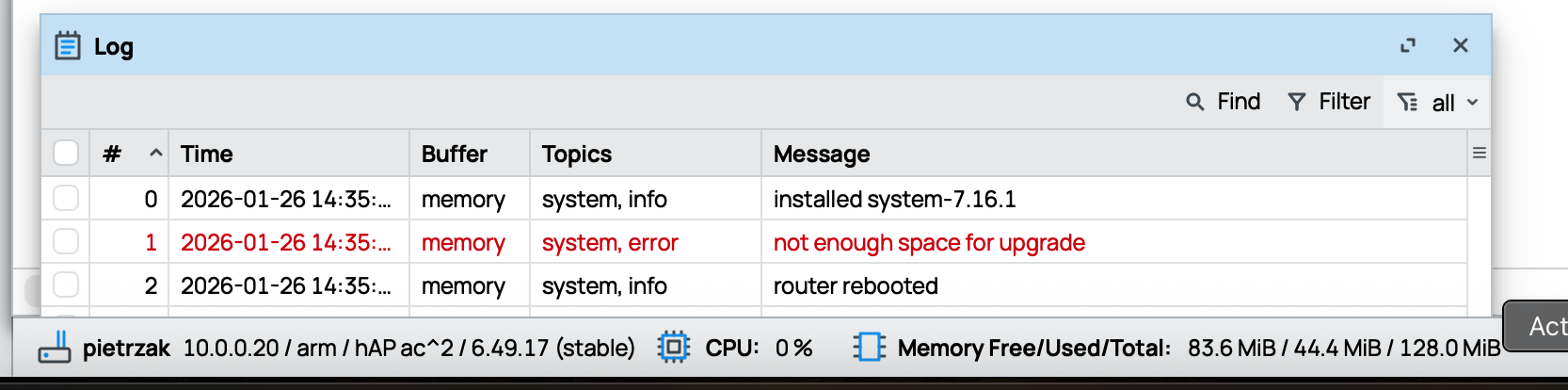

I’m having issues with updating one of my hap ac2 (the other has been running v7.16.1 and it was upgraded using the automatic download & install).

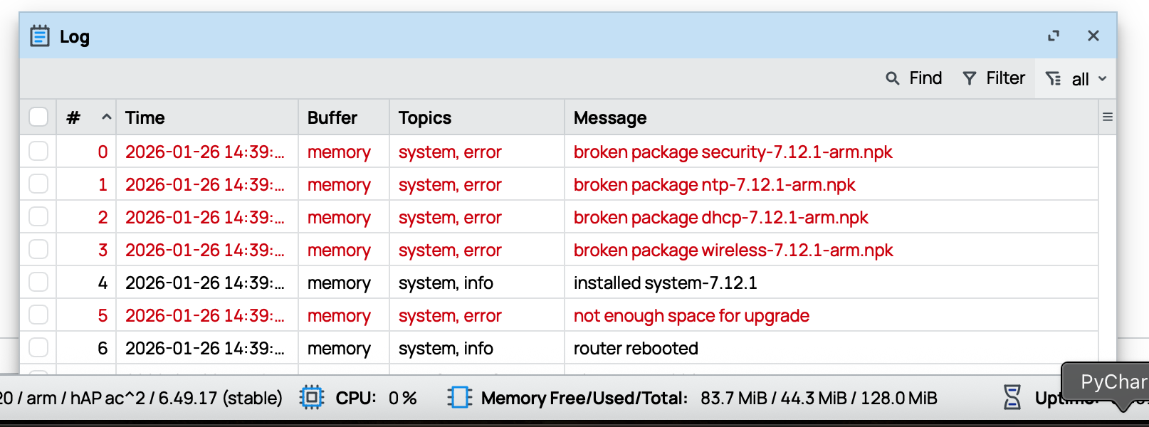

However, now the automatic installation fails due to broken packages and not enough space for upgrade error.

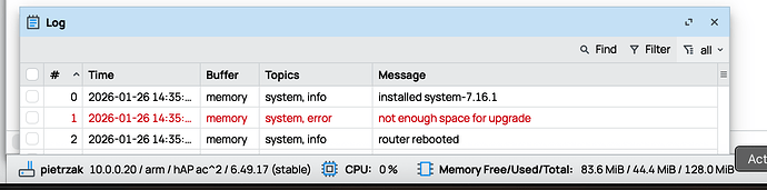

When I tried manually uploading e.g 7.11.2 (inspired by this topic), or 7.16.1 (working correctly on my other hap ac2) I only get the not enough space for upgrade error:
How do I solve this?

Yup.
Something is consuming internal space.
Only way out = netinstall.
Read changelog and update first to 6.49.19, they fix upgrade for multiple packages.
netinstall did the trick, thanks!
