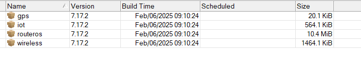

I upgade firmware on my KNOT Router and now apear a red comment on ppp-out1 interface that say A newer version of modem firmware is availabe!, I try to execute auto upgrade but nothing.
I have this packages installed: see attachments
What can I do?

It is in the manual :slight_smile:
https://help.mikrotik.com/docs/spaces/UM/pages/41680915/RB924i-2nD-BT5+BG77#RB924i2nDBT5%26BG77-Cellularmodemfirmwareupgrade
From the console run this command:
/interface/ppp-client/firmware-upgrade ppp-out1 upgrade=yes
Assuming that the modem interface was not rename.
Thankyou xrlls, is just i need.
