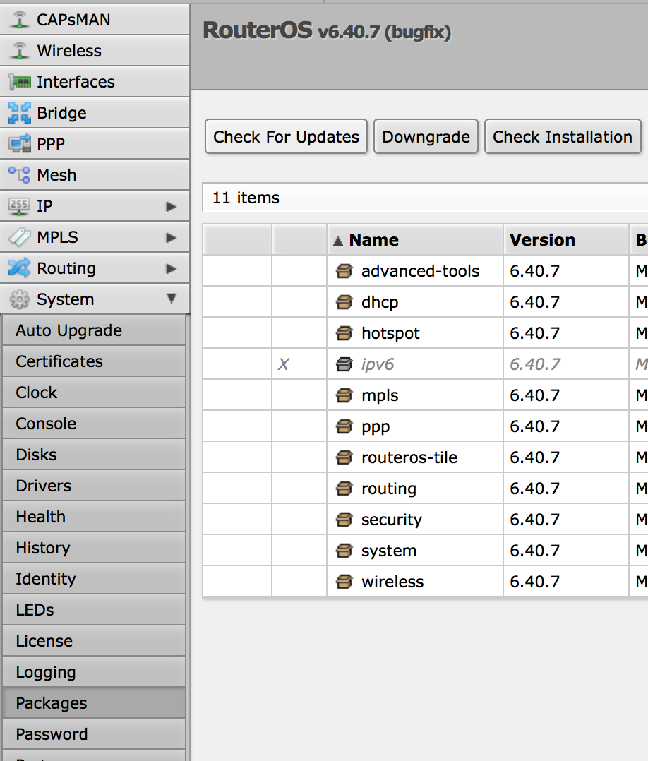

Hi I wanted to see what is the upgrade process from my RB450G (mipsbe)(6.34.1) to the latest one, Can I just upgrade to the latest version routeros-mipsbe-6.42.npk or do I need to upgrade to different versions in between
No, simply upgrade directly to new one. You can do it from Webfig or Winbox, click on “Check for updates”
