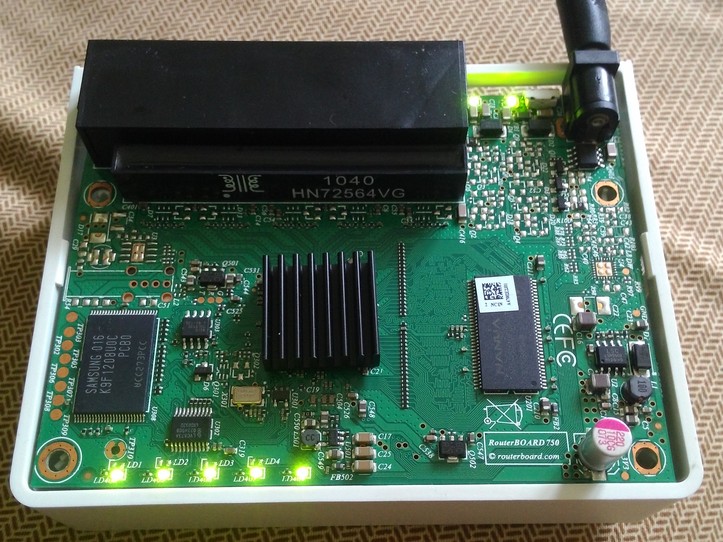

But this time my RB750 bricked after upgraded to 6.1.
Now when I turn on the power, it’s LEDs are always on, no flashing, no off, even I hold on reset button or conneted reset jumper hole.
Is there any way to save my RB750?

Yes I had hold the reset button, but nothing changed. The LEDs are still always on.

No. My RB750 is totally dead. All of Ethernet ports have no response when connect to my laptop. The OS (Win7) shows the network adapter of my laptop is “not connected”.
