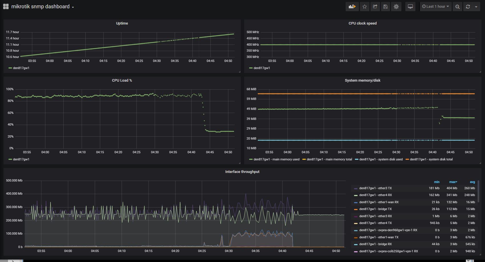

Also attaching new telegraf stats I setup showing detail during the failure. - Attachment seems broken to me, dropbox link if the attachment doesn’t show https://www.dropbox.com/s/lr73z59hb2s5r3q/mikrotik%20stats%20during%20failure.JPG?dl=0

As for the monitoring, it’s telegraf + influxdb + grafana.
