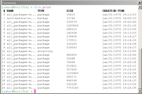

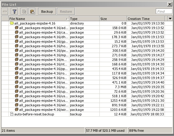

I followed the upgrade instructions and the router still showing 4.13.What has gone wrong? Please see shots below. Thank you.
You need to put the packages into the root directory. Also, only install packages you actually need.

That was the instructions I followed…the drag and drop flies to the files menu. It loaded the files above the auto-before-reset-backup, so I had believed it was uploading the files at the root directory.
So, how do I get the files to the root directory? Also which files I need to eliminate and how to do that?
No, you dragged the directory containing the files into the root directory. Select the directory named all-packages in the File view of Winbox and delete it by pressing the minus (“-”) icon. Then drag the files over into the root - not the directory.
Which packages you need is obviously up to you, and I cannot answer that question for you. Do you use MPLS or IPv6? If not, don’t load them. As in, don’t copy them to the root directory. If they’re not there at boot they cannot be installed.
It is a little frustrating. Is there a symbol or a drop down menu to select the root or am I to type “root” or should open the folder, select all the contents and drag and drop onto the file list?
Yes, open the folder, select all the files, drag them on the folder inside of winbox. Don’t drag the directory the files are in, drag the files themselves. If you drag the folder the files end up in a folder that is in the root, which means that the files aren’t in the root themselves.

Thank you, I finally got it. However, to share, once I had deleted the folder from the file list, it would not allow me to drag all selected files and drop. I had to launch Windows (I am using a MacBook Pro), open Winbox then drag the files. I then switched back to MacOS, launched Winbox and check. All was there.
