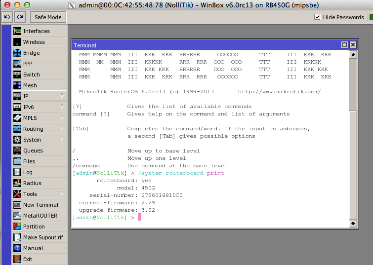

I upgraded the routerboard firmware to 2.29 from 2.28; however, V6.0rc12 still didn’t install and the system isn’t finding any more despite others claiming to have upgraded their RB450G to firmware 3.02. My license allows upgrading to V7.x.
So, why 6.0rc12 isn’t installing?

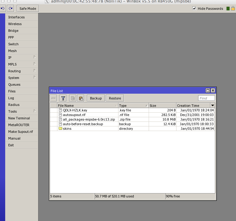

Here’s the other.
you can NOT upload ZIP package. Upgrade this - http://download2.mikrotik.com/routeros/6.0rc13/routeros-mipsbe-6.0rc13.npk

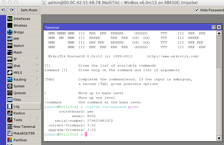

Thank you for responding…That did it.
