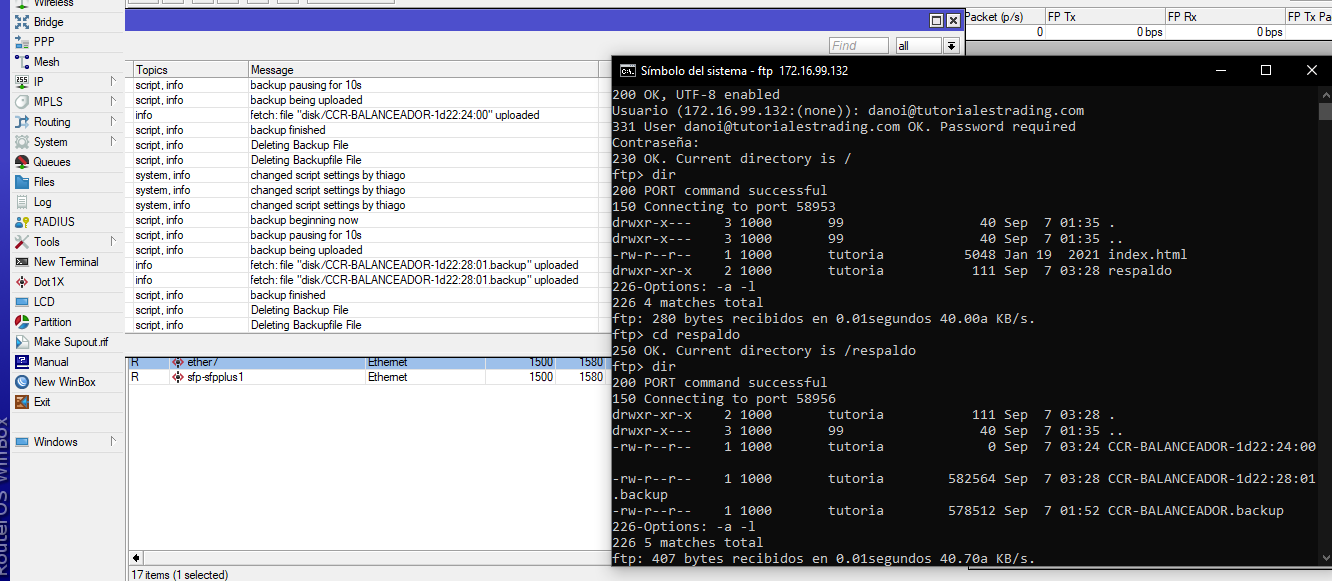

I have attached the screenshot of the log.
but this script does not working. Please help me for solving this issue.
Hello
For me, it works only without a date. After adding the date, it stops.

I did this, it solves the problem of uploading the same name file:
