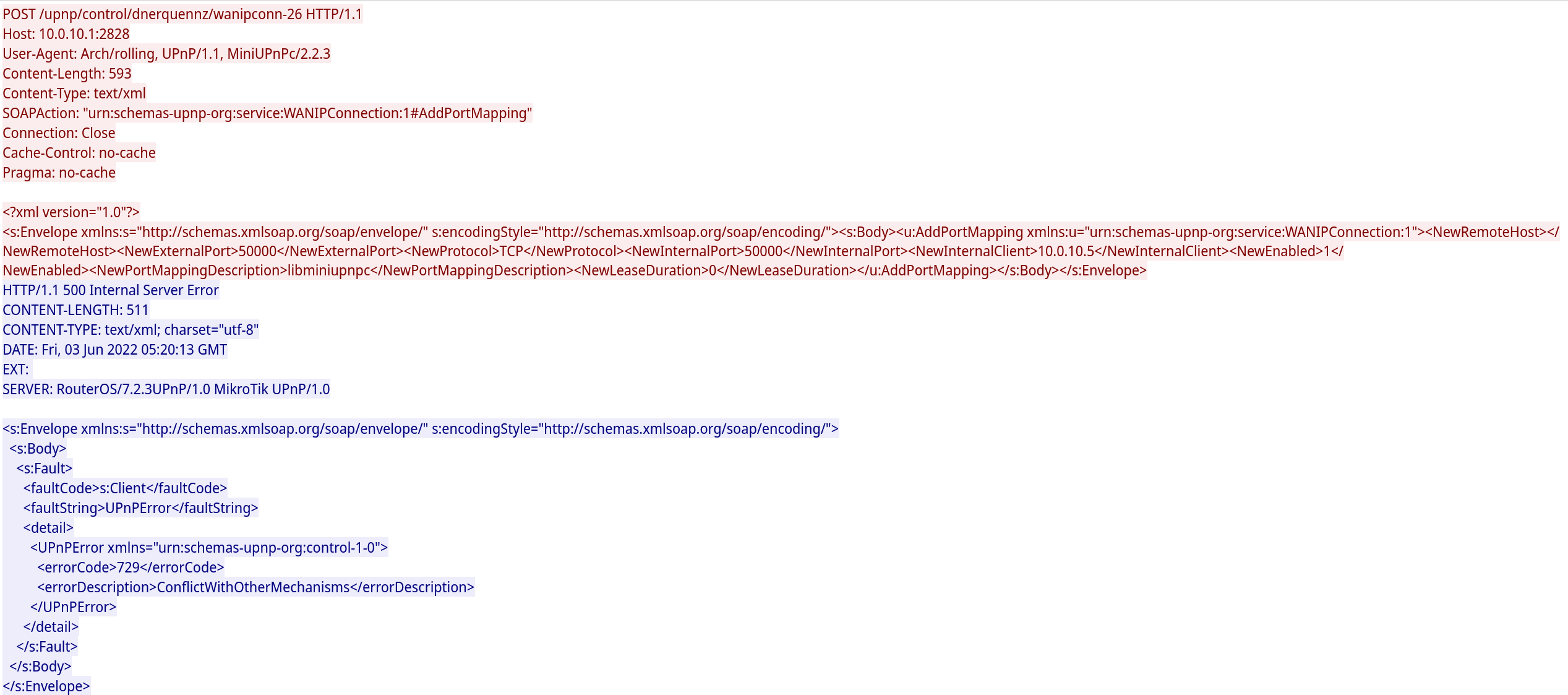

Hey Sob,
This doesn’t show anything at all related to UPnP in the logs which is why I had to dive deeper and collect packets.
Also, Maybe I am using upnpc incorrectly? I tried it using it like,
upnpc -r 27015 27015 tcp
and this gives the 729 error. But applications like EA Launcher(Electronics Arts games launcher) are successfully able to create port mapping entries.
