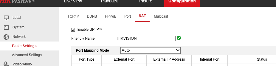

I’m also using a HikVision camera which I have enabled UpnP which include 5 ports.
The problem is that Mikrotik never gets the UpnP info from HikVision.

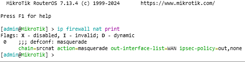

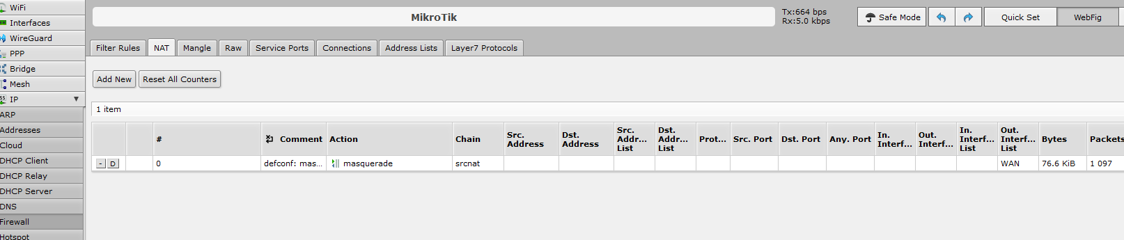

I’m checking /Firewall/Nat and I see only the default masquarade. The NAT checkbox is enabled.
Check the screenshots. Do you have any idea, what are the correct settings in order Mikrotik gets the UpnP info from the camera?
