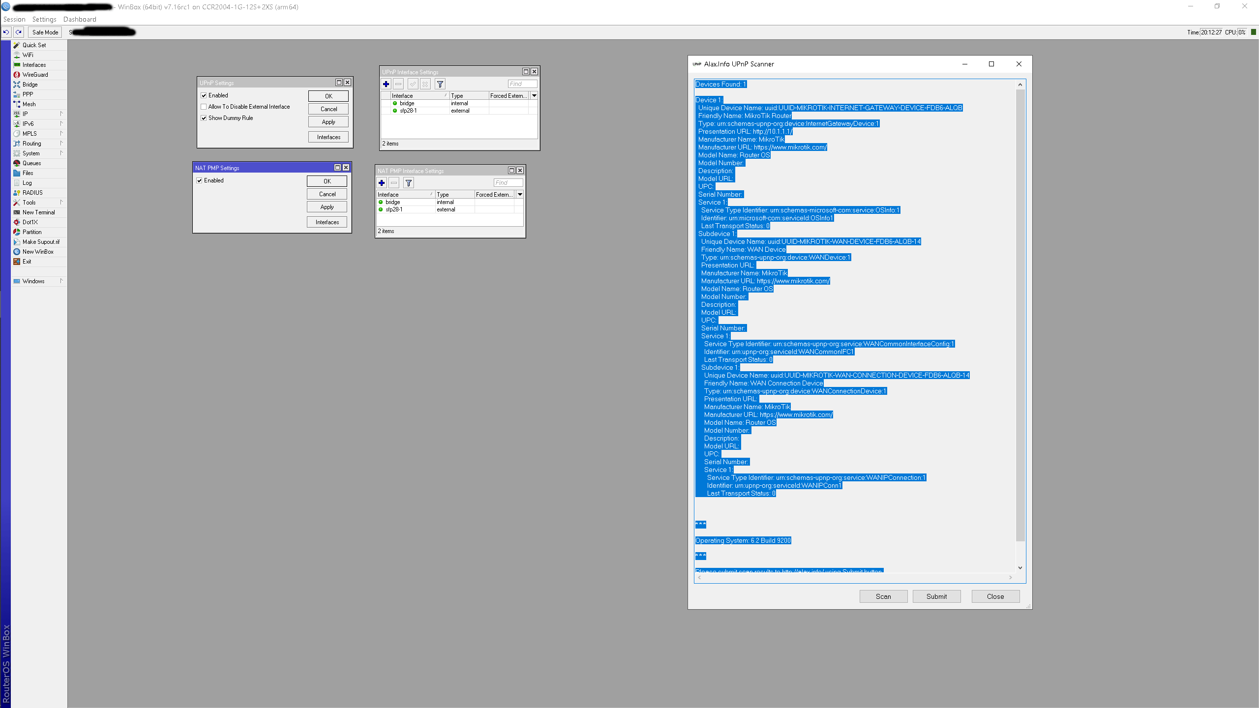

I enable UPnP and set the internal and external interfaces. Internal is a bridge.
I am currently on 7.16.rc1 as i need to QoS and PTP stuff.
As a test to isolate things, I setup a VERY simple setup. A NATed network, no firewall for test, and enabled UPnP with a internal and external network..
Initially this works great.. I see the Mikrotik UPnP entries.. But then after like 15 mins, they are gone.. This seems a bit confuzing to me..

I use this program to scan.. https://alax.info/blog/257
https://www.xymox1.com/Misc/UPnP.gif

The issue of the UPnP service just seeming to die after some time may be specific to a specific model/s. It seems to be working on a CRS309-1G-8S+ and a CCR2004-1G-12S+2XS.. But it does not stay working on a CCR2116-12G-4S+..
It might also be something on the network that is somehow killing the service..
I am investigating further..
While I realize UPnP is a huge mess, this is pretty specific and seems reproducable..
I have now tested the same config copy pasted into 4 different routers. It all works and is stable, exacpt for the CCR2116-12G-4S+..
The CCR2116-12G-4S+ with nothing but one PC connected looks as tho the UPnP service fails anywhere from 3 mins-10 mins. 7.16RC1.. I have not yet tried older firmware.
So just a NAT with bridged ports, allowed everything on the firewall / raw. The same config on other routers works fine. No failed service..
To me this looks like the UPnP service fails.
I can restart it by disabling/enabling. It will then run up to 10 mins and fail again.
