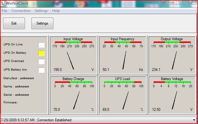

Also there is windows based clients that can allow people to view the input/output voltage/battery voltage remotely in a graphical way.
eg.
And best of all They already support most UPS’s!
Really hope my input can help!
