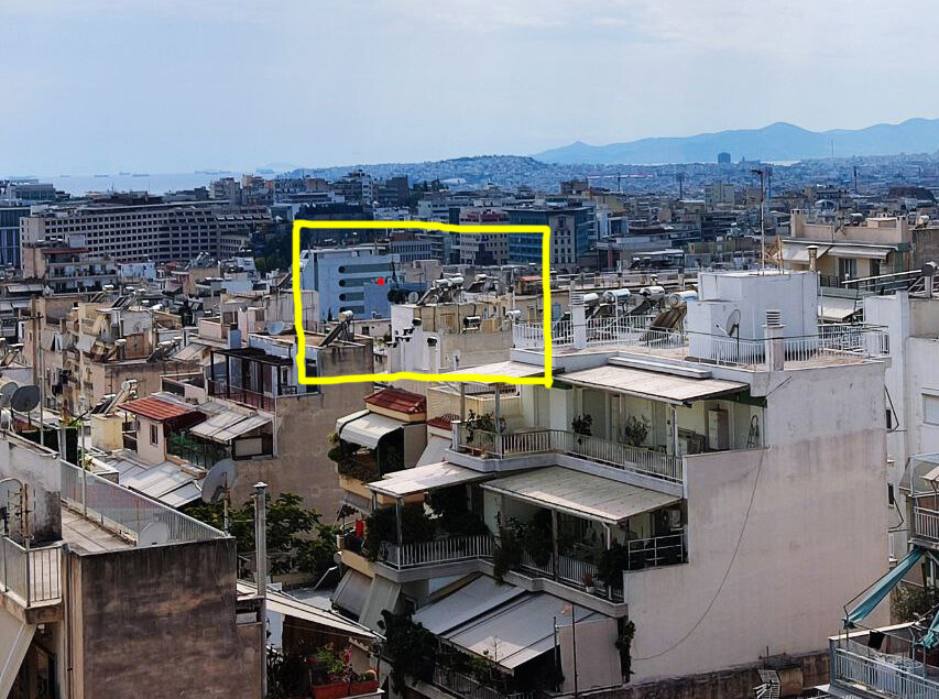

I have to make a PtP link between two buildings in an urban area. As you can see in the following pictures that are taken from the rooftop of the second building, we have line of sight but I’m not so sure about the fresnel zone.

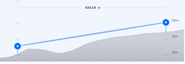

Pic1 - Elevation and distance:
Pic2 -Target roof building:

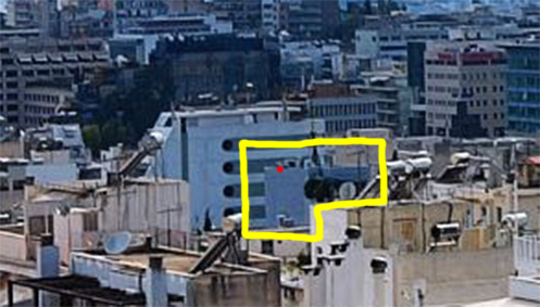

Pic3 - Zoomed IN target Building roof top:
