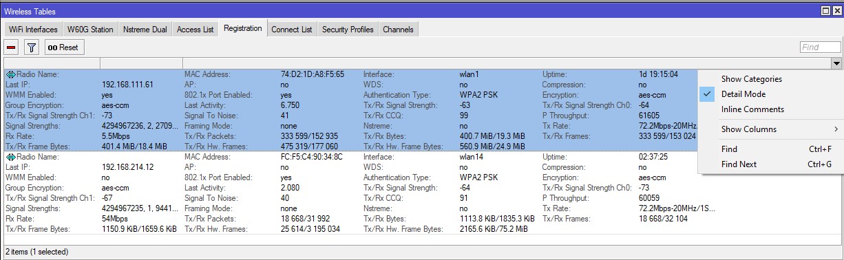

To avoid guesswork, just look at the wireless table “Registration”. You will see the signal strength, the SN ratio, the TX rate and RX rate (speed-bandwidth/streams/guard), the CCQuality, the frames/hwframes ratio retransmits needed, … . Signal above -30 dBm is too strong, signal below -86 dBm is too weak. If rate drops below bottom supported speed =>" Extensive data loss" disconnect.
“Extensive data loss” also happens if client devices wifi goes in off state.
