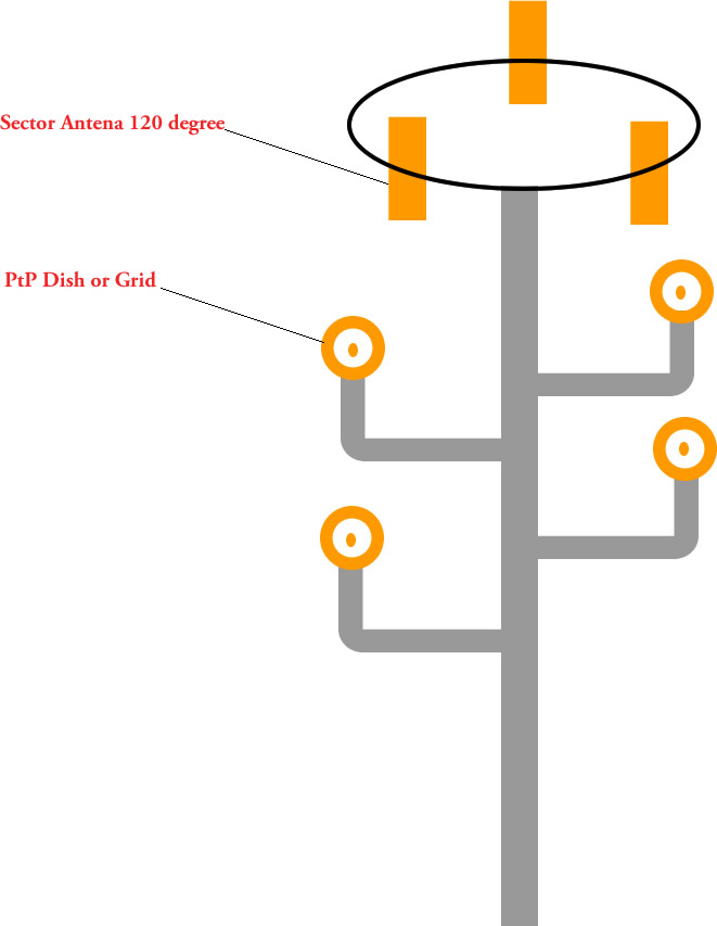

I have only 5 channels in 5Ghz on which I can operate, so if I use 3 of them for sectors, remain only 2 for the same location which I can use for backhaul. But what happens if on the same location I will add another backhaul or more?
In the figure below can you give an example of frequency assigment.
As long as your p2p shots are not too far (your power is not too high), and your selection of dual band dish is suficient, you should be able to use 2 p2p shots with enough antenna spacing and angular seperation.
