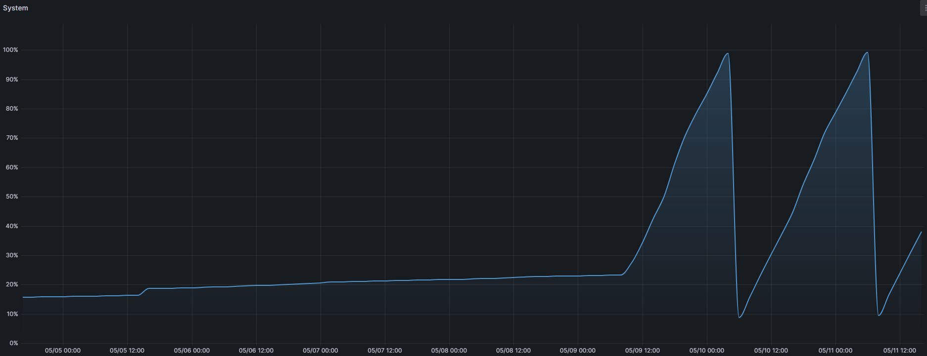

Unfortunately I need help rather quickly, otherwise this Router will continue rebooting every ~26hrs (almost exactly 26h!)
We are having a problem with a CCR1036-8G-2S+ (16G of RAM).
Starting two days ago, one of our routers started to reboot with OOM error messages.
RAM usage shows this pattern:
There have been no changes to the configuration at all according to config history/backup.
What’s the best path to identify the process/configuration that is eating up all those memory?
Thanks for any help!

I wasn’t thinking of a real bug in the OS (we have multiple tenth of them in the field), but thinking of bad configuration and wanted to identify the service/thing we misconfigured. On Linux top/ps would have told me the ressources used per service. On Mtk I don’t know anything like it.
Thanks, will get back here as soon as I know more.,
Hi again,
I wanted to update this posting.
  • No (D)DoS
  • No DoH
  • No dynamic address-lists
  • Not debuggable with on router tools
  • Ticket opened (SUP-129092, with at least two supout files of impacted routers) but didn’t get any replies
  • 5-6 routers that crashed regulary because of this in different cycles, so it’s not just equal timing, it must be some kind of load/traffic/usage dependent problem
I’m thinking:
  • Logging (storage)?
  • IPsec stuff?
Regardless, I tried updating one of the routers to 6.49.10 and the problem disappeared. Memory usage doesn’t climb above 7% now.
So I updated the other 29 routers still on 6.48.6 as well.
Everything is fine now. Still it bothers me, not to know what caused it.
BR,
Irrwitzer
