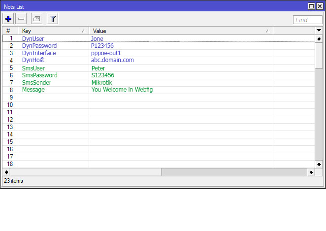

So that the input and modification of the values required for variables in the scripts are restricted to the normal user level of this screen only, and to prevent it from accessing and modifying the scripts or changing the content “if using Webfig”. The basic editing of scripts is restricted to the administrator, And minimize the exploitation of comments , And far from using [/system script environment]
Do I find support for it?
I want a big business , I have a lot of micro-routers, and requests from customers
This is very important in case of customization WebFig
Example script 1 :
:local DynDnsUser [/system nots-list get DynUser]
:local DynDnsPassword [/system nots-list get DynPassword]
:local DynDnsInterface [/system nots-list get DynInterface]
:local DynDnsHost [/system nots-list get DynHost]
Example script 2 :
:local SmsUser [/system nots-list get SmsUser]
:local SmsPassword  [/system nots-list get SmsPassword]
:local SmsSender [/system nots-list get SmsSender]
:local SmsMessage [/system nots-list get SmsMessage]
Thank you all ..

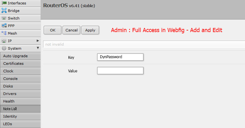

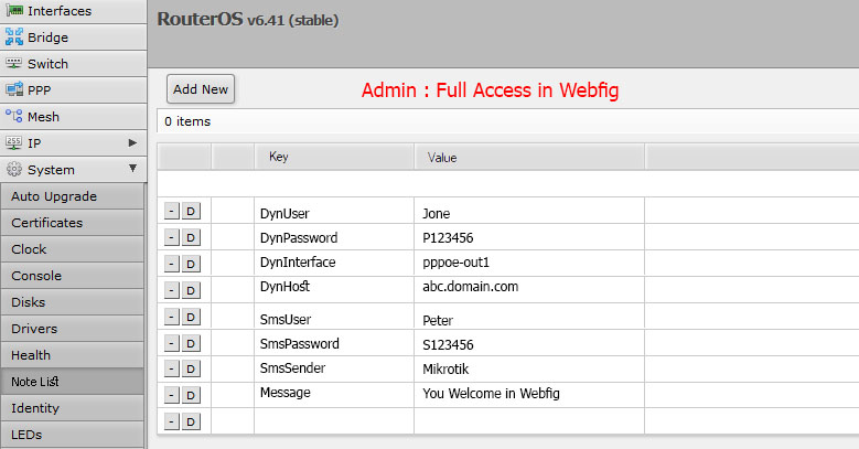

this example my dear …
This is required
I do not want any User Limited access to script or edit any script , only edit value from note list
This is very important in case of customization and Design Skin WebFig

i have 30 router model : CCR1036-8G-2S+
1/ I want to make special settings and configuration in routers , too create special scripts
2/ I want to create a limited user
3/ I want to create a Design Skin custom and limited by WebFig
4/ make user limited allow access to this Skin by WebFig
5/ I want to block limited user access to (system scripts) in WebFig
But this programming script needs to change some value in variables
The only solution to prevent the limited user’s support to programming and give it the power to change the value of some variables…
As shown in previous pictures also by way of calling the value from that window
Only the process of regulation and protection
