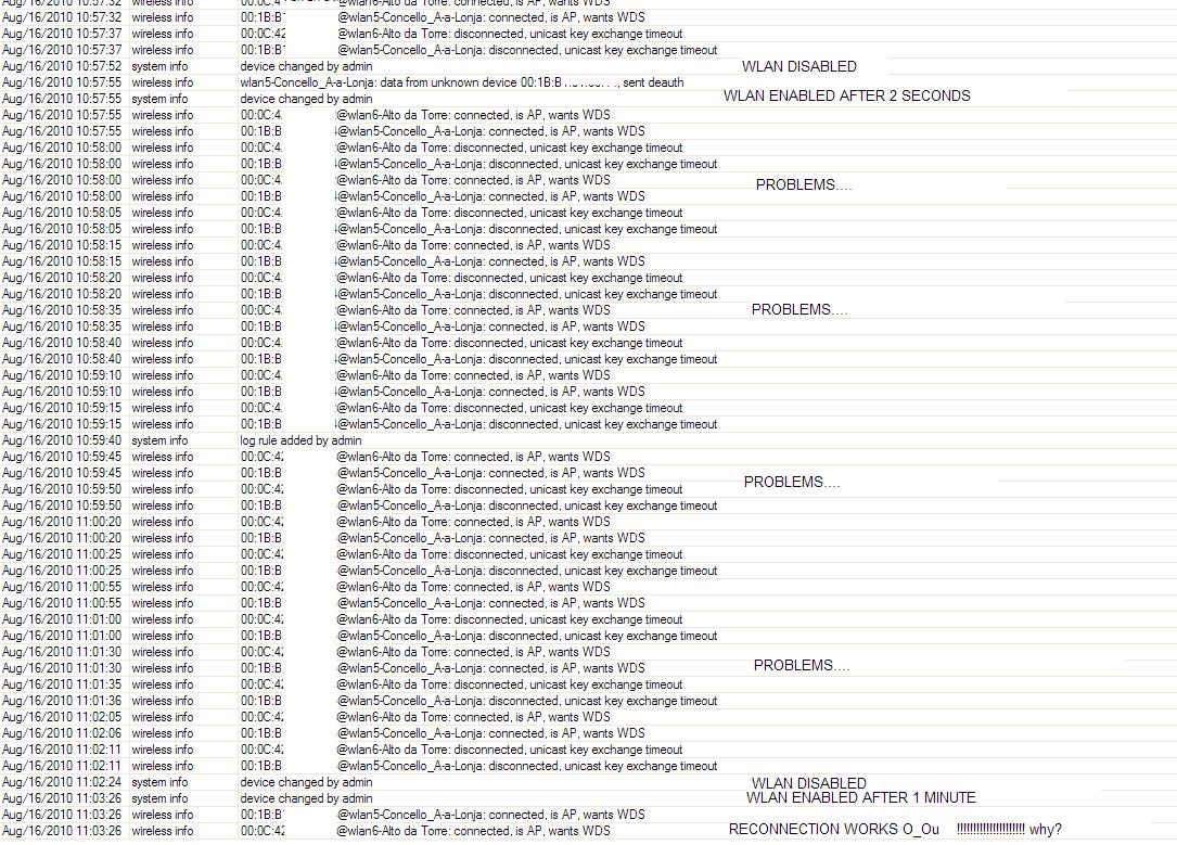

Hi all,
I’m having problems with 2 APs in the same instalation.
Both APs with ROS 4.9.
APs hardware is 433AH and XR5s.
Hotspots hardware are UB5 or R5H connecting with one radio to the APs and with a hotspot in another.
My APs has ap-bridge mode and are getting costumers to the master interface or to the VirtualAP1, with a hotspot on it.
Also I have virtual APs to make wds links to many repeaters (2 or 3)
My links are with static WDS and are working fine, till I get the unicast key exchange timeout problem when the AP is bored.. =_=
I’m using WPA keys instead of tkip and I use one wpa key fot the hotspot users and another one for the repeater links.
I can solve the problem by disableing master interface for 20-30 or one minute and enabling it.. but, why it stops linking with the repeaters?
Al the links are with signal of -65 and 100% CCQ. All the network is 5GHz and no turbo mode.
I noticed that if you change anything in a virtual AP, al the others disconnects and then reconnects, but there is sometimes that only one reconnects, perhaps 2, or perhaps.. all the 3 repeaters.. it depends on a random variable that I don’t know what is.
ITS POSSIBLE TO FIX IT DOING SOMETHING?

screenshot attached.
