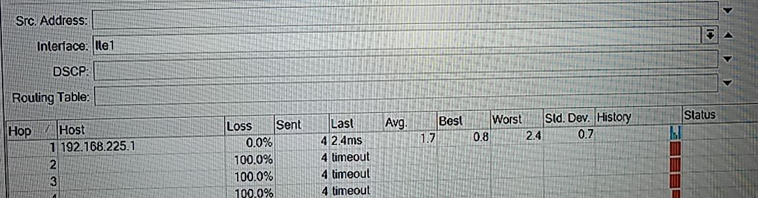

Problem description:
r11e-LTE6 have other IP Address and Routing then LM940.
LTE6 have working internet but LM940 only can ping the next-hop/gateway itself.

  2. At RBLHGR 6.47beta35 + Telit LM940 we get:
    IPv4 Address:
    1 D 192.168.225.11/32 192.168.225.1 lte1
    IP Route:
    0 ADS dst-address=0.0.0.0/0 gateway=192.168.225.1 gateway-status=192.168.225.1 reachable via lte1 distance=2 scope=30 target-scope=10
    2 ADC dst-address=192.168.225.1/32 pref-src=192.168.225.11 gateway=lte1 gateway-status=lte1 reachable distance=0 scope=10
    3 ADC dst-address=192.168.225.11/32 pref-src=192.168.225.11 gateway=lte1 gateway-status=lte1 reachable distance=0 scope=10

We receive this message:
AT&T Free Msg: It looks like you want to use data but have none available. You may need to add a data package or change to a plan that supports data for your device. To check your plan and manage your account
Maybe some one know what this means ?
AT&T Support give us info, you must use APN: NXTGENPHONE and no more other info :frowning:
Solution: not use a SIM card who have a Plan for MOBILE.
AT&T detect some IMEI (lte modules modems) and just not give them internet because they are not MOBILE.
Buy a “Tablet Plan” who will be working. Working at more bad bands and that’s why we move to Sprint who merge with T-Mobile and this will be best deal to use.
