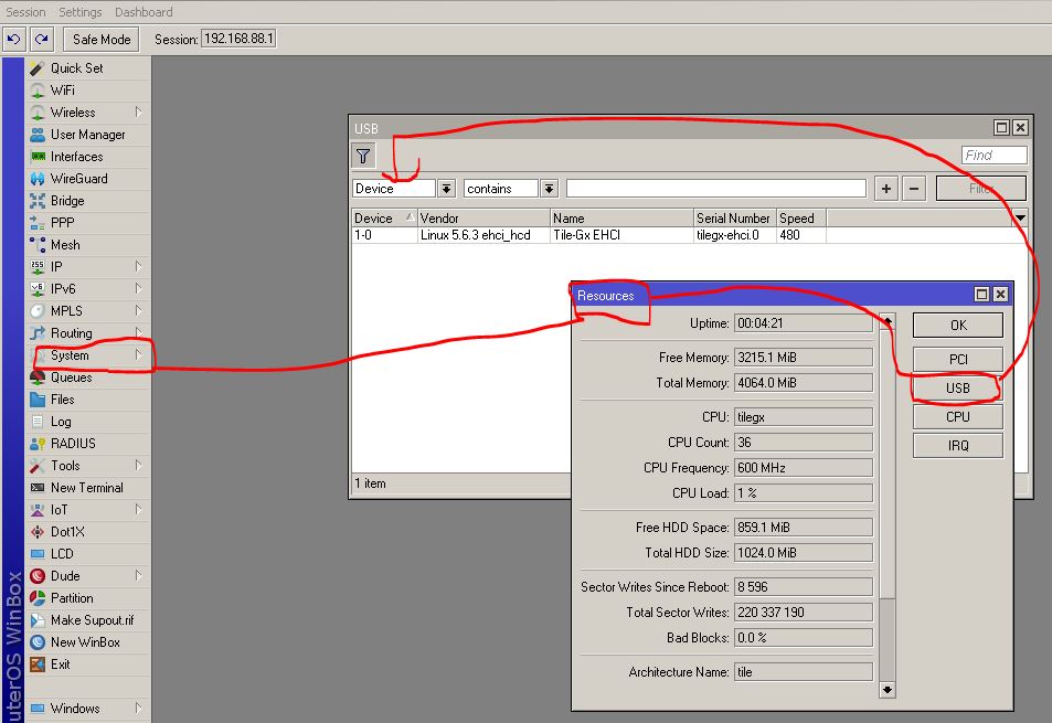

After removing my mobile phone from Microtik CCR1036-12G-4S, USB port, the RouterOS always show it, no matter i reboot CCR1036,
shut if off and turn on, reset USB power, restore whole system from backup, it just stays there not able to be removed.
I Google the post on 2014, said the only way is to do netinstall, but the tutorial link gone. After 10 years, still only way is to netinstall to remove a plug and play usb device? Any help, please?

[godel.chen@FairayRouter] > /system resource usb print value-list
device: 1-0
vendor: Linux 5.6.3 ehci_hcd
serial-number: tilegx-ehci.0
vendor-id: 0x1d6b
device-id: 0x0002
speed: 480
ports: 1
usb-version: 2.00
flags:
This is the “usb root hub”, the router side of the USB bus. It was always there, also before you connected your phone. You cannot remove it.

I just netinstalled my CCR1036 and restore my configuration…Thanks. :slight_smile:
No wonder after i netinstall it the device is still there…
Thanks, it seems Mikrotik is the vendor…“vendor-id: 0x1d6b”
1d6b  Linux Foundation
	0001  1.1 root hub
	0002  2.0 root hub
	0003  3.0 root hub
