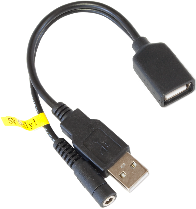

Powered HUB won’t work, you must use a USB power injector.
Distributor should have provided you with this info, and the injector cables they should have for sale.

I made my Verizon air card work on a 411UAHR board. I did not have the power injector as show above but using a 7805 and a few caps you can build a filtered 5 volt supply and just solder the 5 VDC output to pin 1 on the RB 411UAHR USB plug. That way you do not have a bunch of extra crap to plug in. The USB pin 4 ground is tied to the ground plane on the PCB already. You will need to put a heat sink on the 7805. I have added a fan to cool the radios and everything because I use the unit in my truck.
