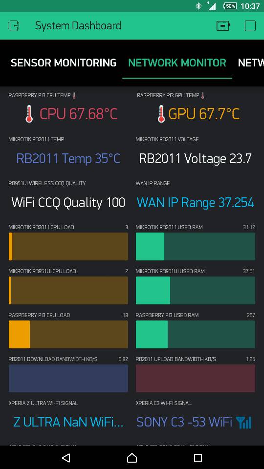

use IoT based system. I’m using raspberrypi

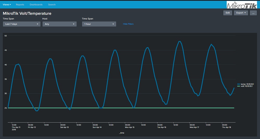

The Dude can monitor, graph and alert on your board’s internal temperature.
Same can Splunk (full version) , see my signatur link for more info.
PS this Router is stored in a place where the sun heats its up in the day time :slight_smile:

[quote=nitin2468 post_id=799583 time=1591874945 user_id=165464]
Why waveform doesn’t go accurate? sometimes high and sometimes low
[/quote]
Jotne’s waveform? It’s temperature: Day and night change…
My router is up in the attic, so outside temperature and sun on the roof makes nice sinus curves :slight_smile:
