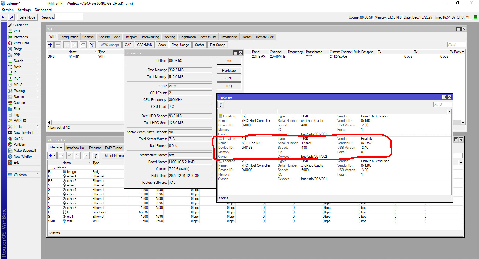

My imagination tells me that I want to insert a USB Wi-Fi client adapter there to connect it to a remote network. I insert it. The system sees it in the devices list. But nothing appears in the interfaces. I suspect that theoretically it's possible. But has anyone encountered this in practice? Do I need drivers or some kind of package? Or is this completely impossible, and it's easier to just forget about it?

Mikrotik does not offer Realtek wireless drivers.

Mikrotik npk package format is signed.
Maybe it is possible to run OpenWRT container and assign the USB hardware to container.
Unfortunately it is not possible as the drivers are inside the main RouterOS .npk, you cannot modify it/install new drivers.
But even if you could, there would probably be the need of manufacturer/specific chipset USB drivers, and who would write them?
Maybe USB wireless adapters exist that expose a RNDIS interface (but this has to happen in the actual USB device firmware)?
