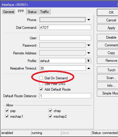

setup the hotspot done , work normal , problems this if power off router , or other powers problems (reset ,) 3g mogem dont connect automatic , dont up link 3g :slight_smile:
Did you uncheck “dial on demand”?

yes I uncheck " dial on demand"
