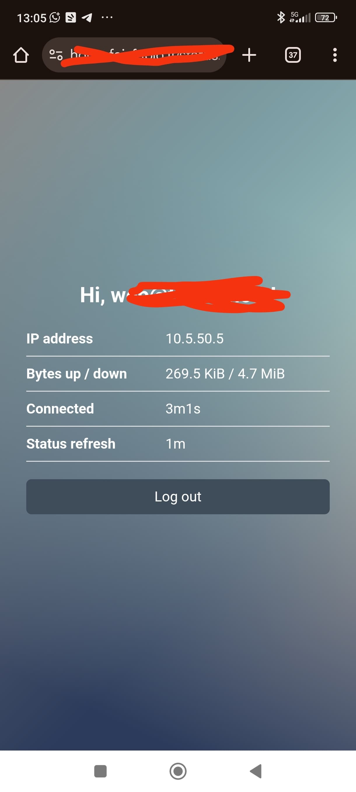

I guess both were true:

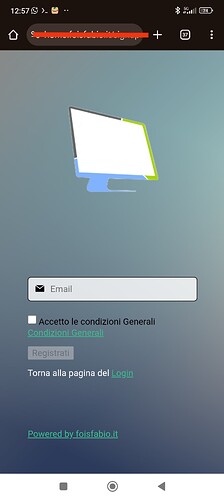

... in 7.22beta1, it seems this "hotspot-over-wireguard" was added:
Now I have not tested it yet, but still think it's a worthwhile concept.

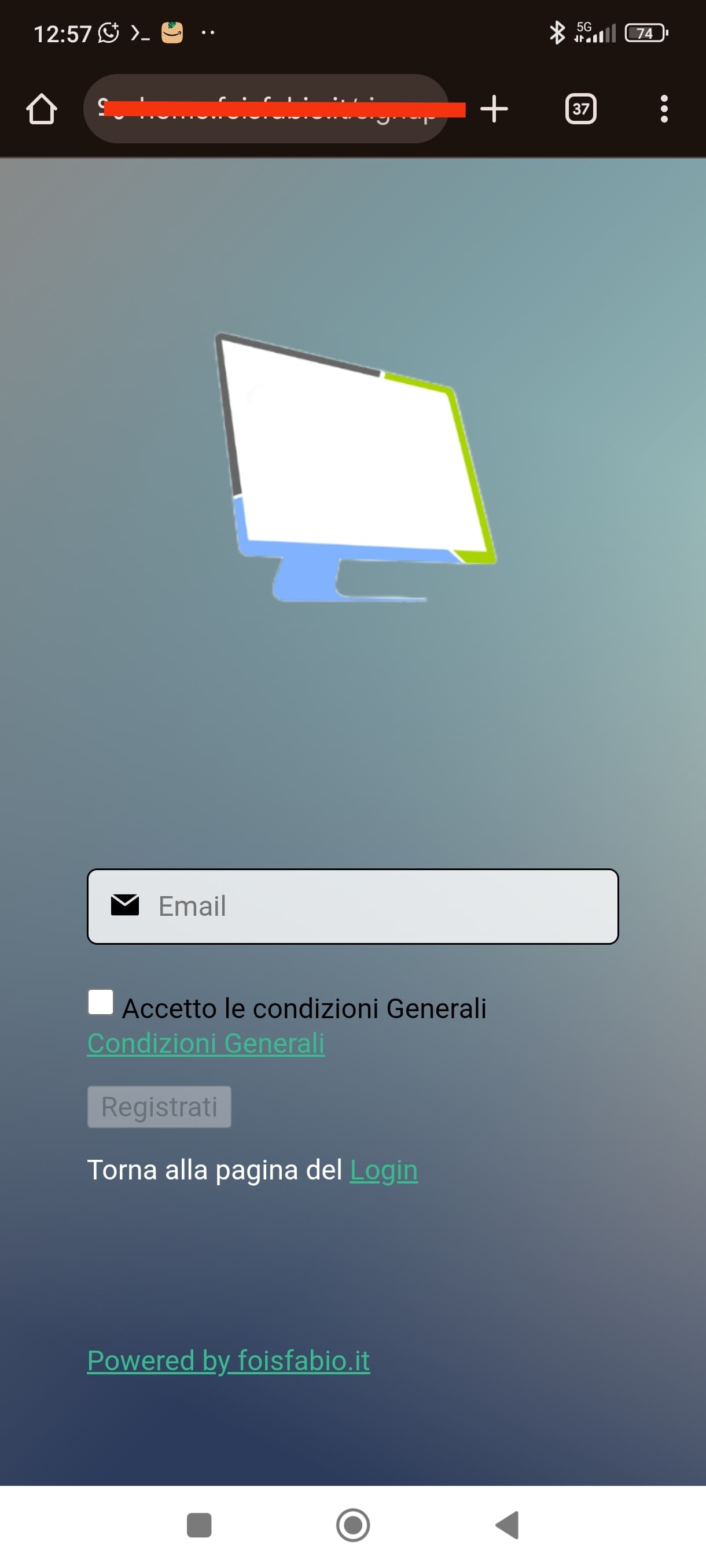

I did a quick test and see login coming up if navigated, and see a user session. Now it did not fully work in https, but that may be related to testing 7.22 reverse-proxy.
Also, importantly, with WG you cannot use DHCP option to flag the captive portal. I did not fully configure it and the SSL/https is tricky business to get right. So how to force pages to login is something IDK yet... RN, I think, you're waiting to hit an http:// URL otherwise (AFAIK - not a hotspot expert & did not mess with it much)

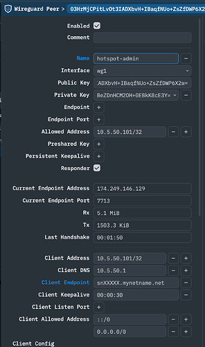

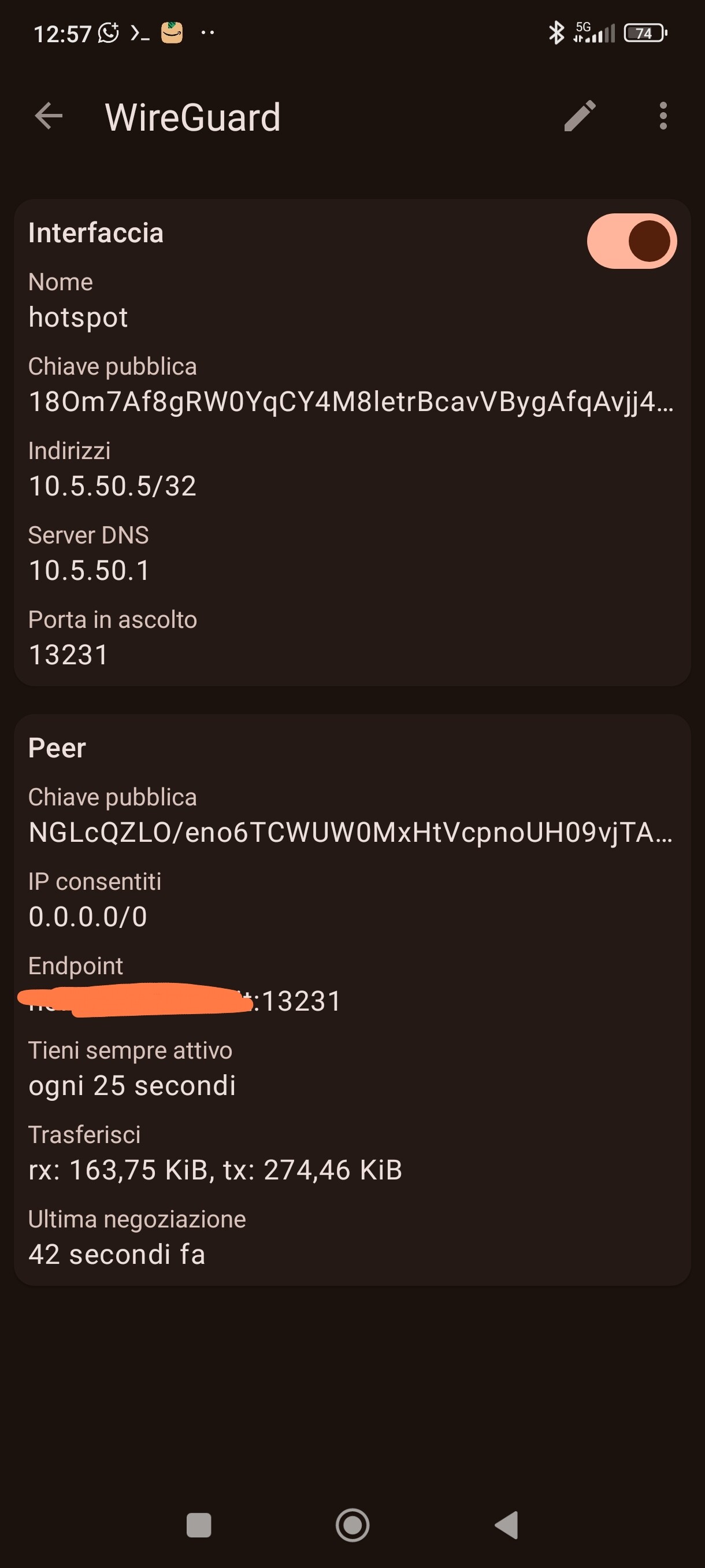

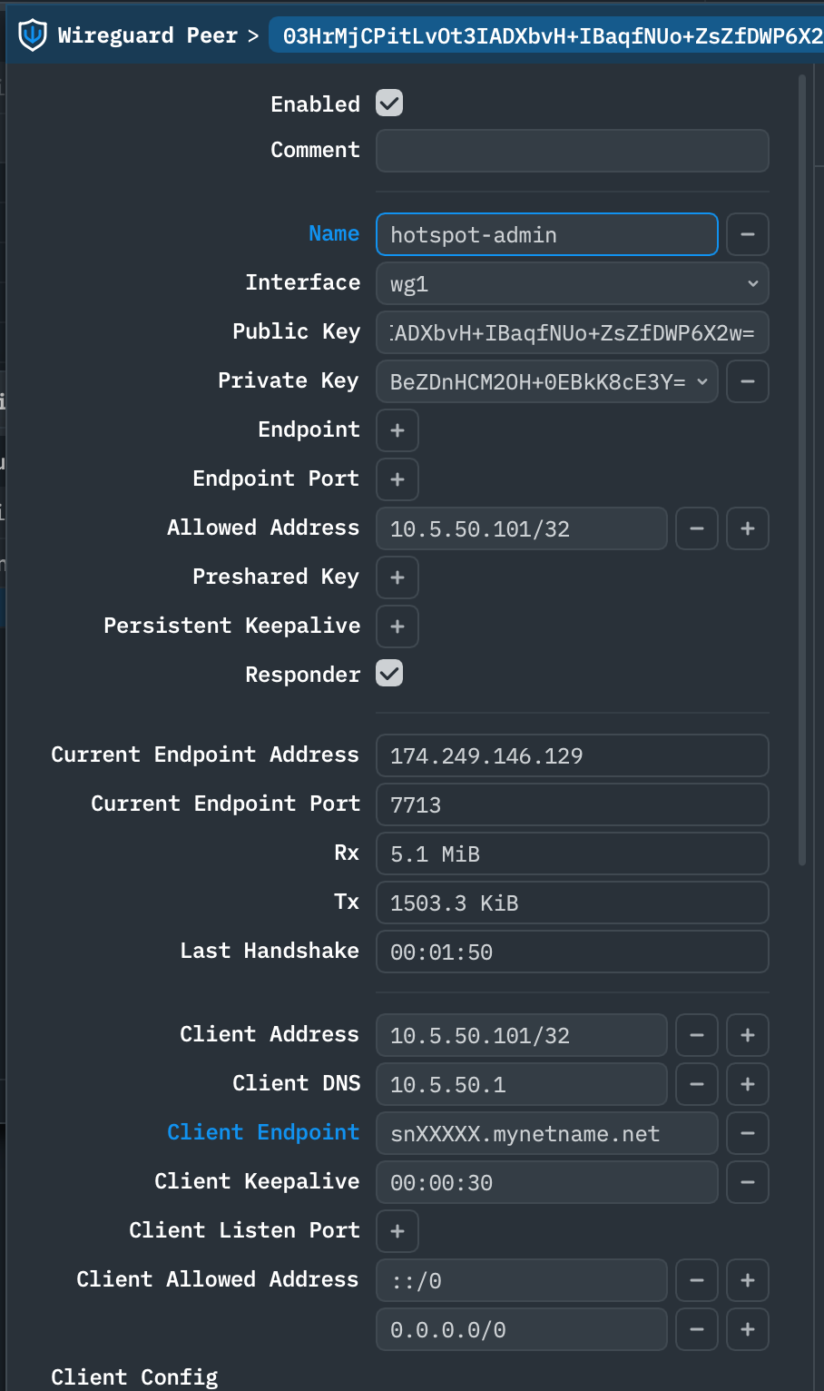

But I added a new WG interface, allowed via firewall filter, and created a peer like this which used 10.5.50.101 on "WG client" which is within the range used by /ip/hotspot/setup with default and using wg1 as interface in hotspot, having done a /certificate/enable-ssl-certificate beforehand.
This was the WG peer I used — which may not be 100% right — used on an iPhone with WG client, and via LTE (so not on same LAN as test).
And, I suppose you could do this on BackToHome WG peers too, and set /ip/hotspot to use BTH's 192.168.216.0/24 subnet, and turn BTH into WG-as-a-service. Or, more practically, for testing this hotspot-over-wireguard feature, since BTH at least deal with peer configuration and "sharing" configs

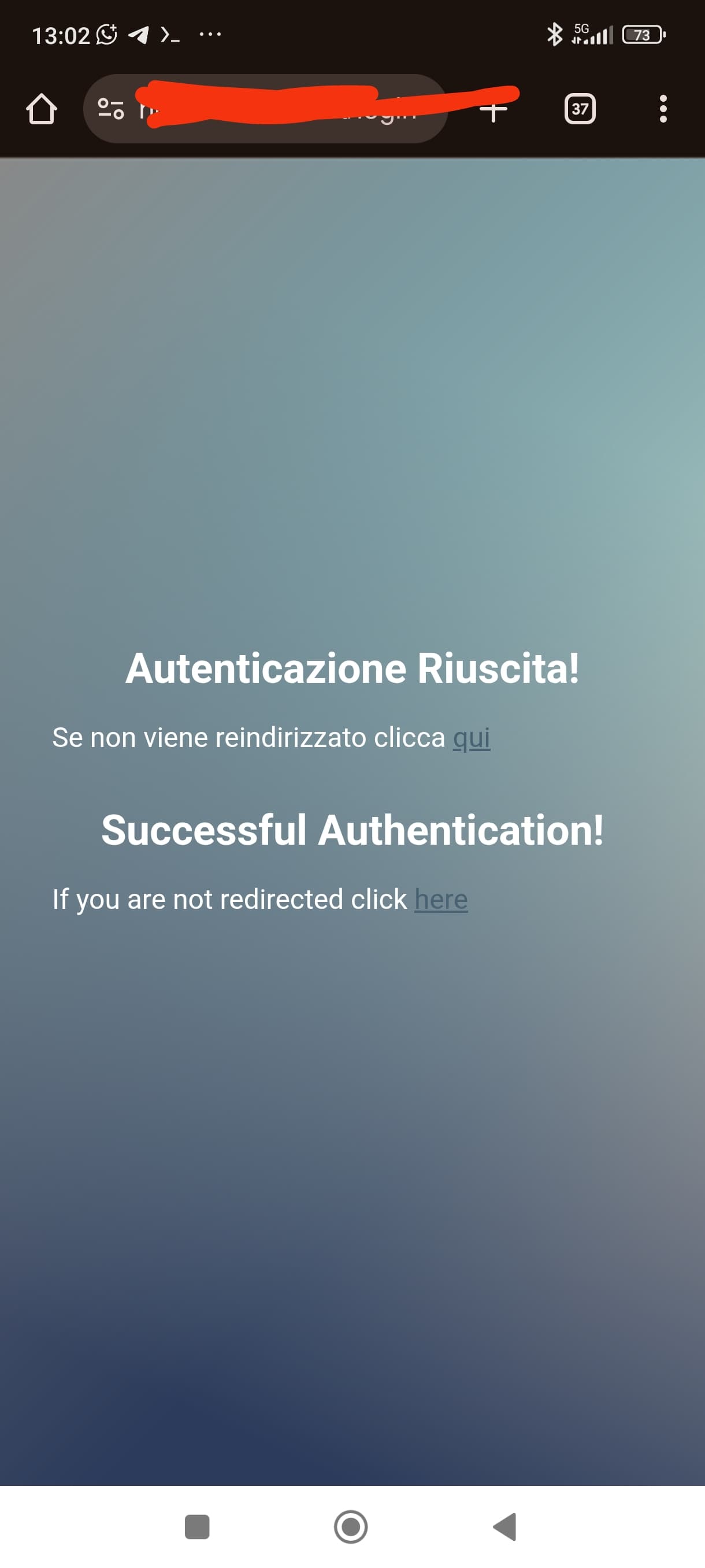

It also works perfectly with https and user manager.
/ip hotspot/host/print
Flags: D - DYNAMIC; A - AUTHORIZED
Columns: MAC-ADDRESS, ADDRESS, TO-ADDRESS, SERVER
#    MAC-ADDRESS        ADDRESS    TO-ADDRESS  SERVER
0 DA 00:00:00:00:00:00  10.5.50.5  10.5.50.5   hotspot1
/ip hotspot/cookie/print
Flags: M - MAC-COOKIE
Columns: USER, MAC-ADDRESS, EXPIRES-IN
#   USER              MAC-ADDRESS        EXPIRES-IN
0 M web@fxxxxxxo.it  00:00:00:00:00:00  4w1d23h59m44s
/user-manager/session/print
Flags: A - active
 0   user=web@fxxxxxxo.it acct-session-id="80500001" nas-port-type=wireless-802.11 nas-port-id="wg8-hotspot" nas-ip-address=127.0.0.1 calling-station-id="00:00:00:00:00:00"
     user-address=10.5.50.5 status=start,stop,interim,close-acked,expired started=2026-01-08 10:52:18 ended=2026-01-08 10:58:33 terminate-cause=lost-service uptime=6m15s download=15.2MiB
     upload=967.3KiB last-accounting-packet=2026-01-08 10:58:33
 1 A user=web@fxxxxxxo.it acct-session-id="80500002" nas-port-type=wireless-802.11 nas-port-id="wg8-hotspot" nas-ip-address=127.0.0.1 calling-station-id="00:00:00:00:00:00"
     user-address=10.5.50.5 status=start started=2026-01-08 10:59:40 uptime=0s download=0 upload=0 last-accounting-packet=2026-01-08 10:59:40
