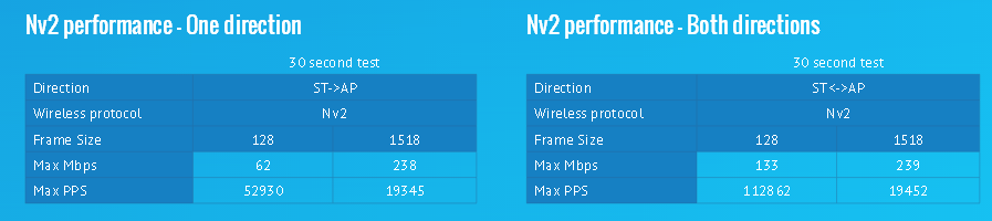

like it said in the news latter? and in the image ?
does it mean using both main and secondary Ant (Main&AX)?and using 2 more antennas?

Your configuration is correct. The pictures in the newsletter just show how they did the tests. In the first case they make the test only in 1 direction and in the other they put load on the link on both directions at the same time.
