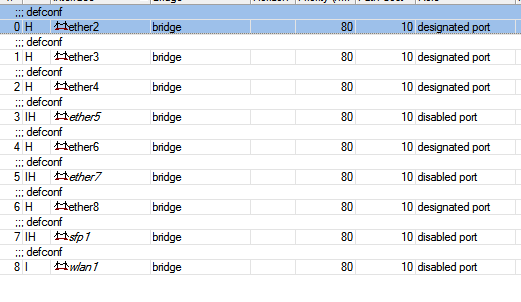

At the moment it looks like all interfaces are set to the same bridge:
So is it just a case of removing the pre-configured DHCP server and network, IP pool and address list?
