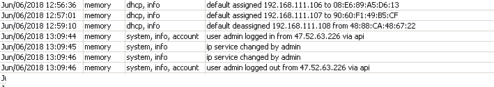

User admin logged via API
I found on 5 of my Mikrotik router with v6.42.3 some weird connection.
See attachment.
The change made by the remote logging that come from china, is Changed telnet port back to 23, changed ssh port back to 22.
Look like an automatic process, because 5 router have the connection at the same time…
What do you think about that?

Log says IP services were adjusted. What changed?
SSH port changed from custom port to 22
Telnet port changed from custom port to 23.
