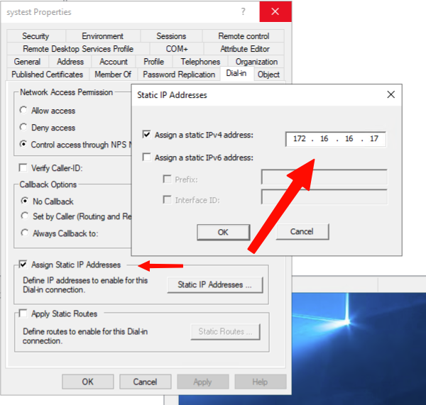

My first idea was to assign static IP in the AD-Dail-in Settings to pass “Framed-IP” over to the Mikrotik.
But it didn’t work. Mikrotik still assign Addresses from his pool to the Clients.
Any idea how Mikrotik will use the Framed-IP Attribute (not sure if the Dail-in AD Setting is the Framed-IP) or how i can create used defined rules? Maybe based on the defined Active Directory Group?

If i set in the AD Dial-in a static IP for the User
the Mikrotik recieves 255.255.255.255 as Framed-IP

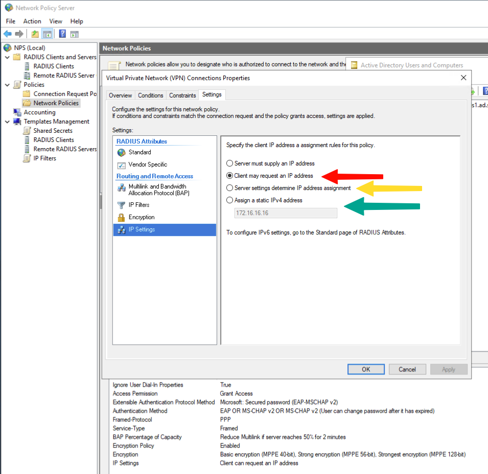

Red Arrow, the 255.255.255.255 is recieved by Mikrotik
Yellow Arrow, Mikrotik will assign from the IP-Pool in the IPsec Mode Config
Green Arrow, this works, if the IPsec Mode Config Pool is removed. But then i have to create a Policy for every user in the NPS? Feels wrong.

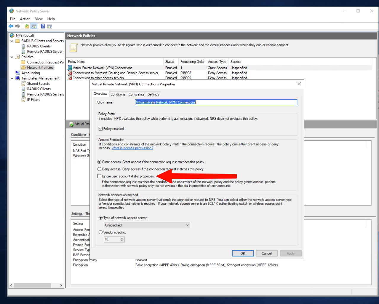

Solution :white_check_mark:
This Checkbox has to be clear - then everything works as expected.
Maybe you have to Adjust your IPsec Policy in Mikrotik to match the Assigment in the AD Dial in User Attribute.
From the oreilly RADIUS Book:
There are two specific IP values reserved for use by RADIUS. The address 255.255.255.255 is used when the client computer negotiates for the IP it uses. This may be when the user has an assigned static IP address and needs to communicate directly with the IP provisioning equipment in order to get this address. The address 255.255.255.254 is used when the RADIUS client issues the IP address.
