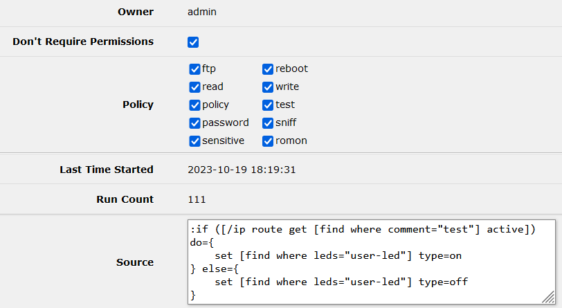

thank you for the tip, but this also does not work in System >Script section.
If I run the script with the “Run Script” button(or a created scheduler task reaches the 60 seconds) LED not changing to on.
Steady off.
I have RB750Gr3 with latest OS 7.11.2.
If I set the LED from the System/LEDs menu (GUI) to set on or off, then it’s ok. Seems that the script is not controlling the LED this way.
Any other tought?
Prior thanks.
I would correct my self.
The script works well. :smiley:
Precondition is to Enable and configure an Off state to the user LED.
After the setting, script runs immediately and LED follows the condition.
Thank you the help.
