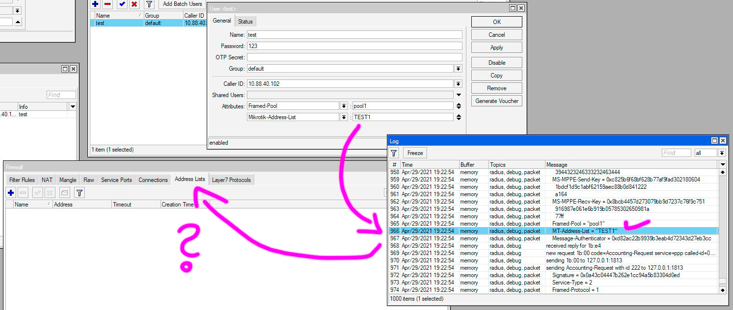

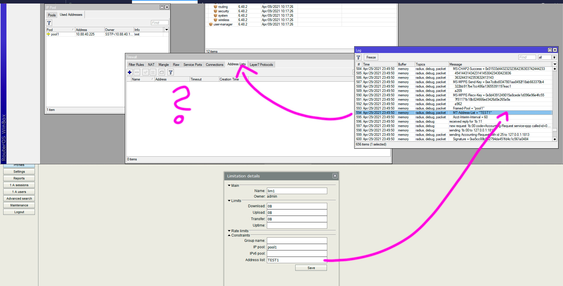

why is the Address-List (TEST1) not dynamically inserted:
The IP from the IP-Pool is given correctly to the client, but the Address-List is not inserted?

Is there another way to add RADIUS authenticated users (IPs) to an Address-List?
AFAIK this should work:
Address list. Sent to Radius client as Mikrotik-Address-List attribute. Indicates to which “ip firewall address-list” should the remote address be added.

yes, above it is the current V7 beta. Tested the 2FA OTA-Auth, this works great with the Google-Authenticator-App.
Unfortunately we work a lot with Address-Lists to filter VPN-User access.
But the same happens with V6.48.2
I am almost sure I do something wrong. But I cant figure out what? And, to be honest, the documentation is really weak ![]()
Hello good, I wanted to see if you could help me with what you publish, that is, see if you managed to solve it, because I am in the same situation add the address-list and when the user authenticates the address-list does not appear.
