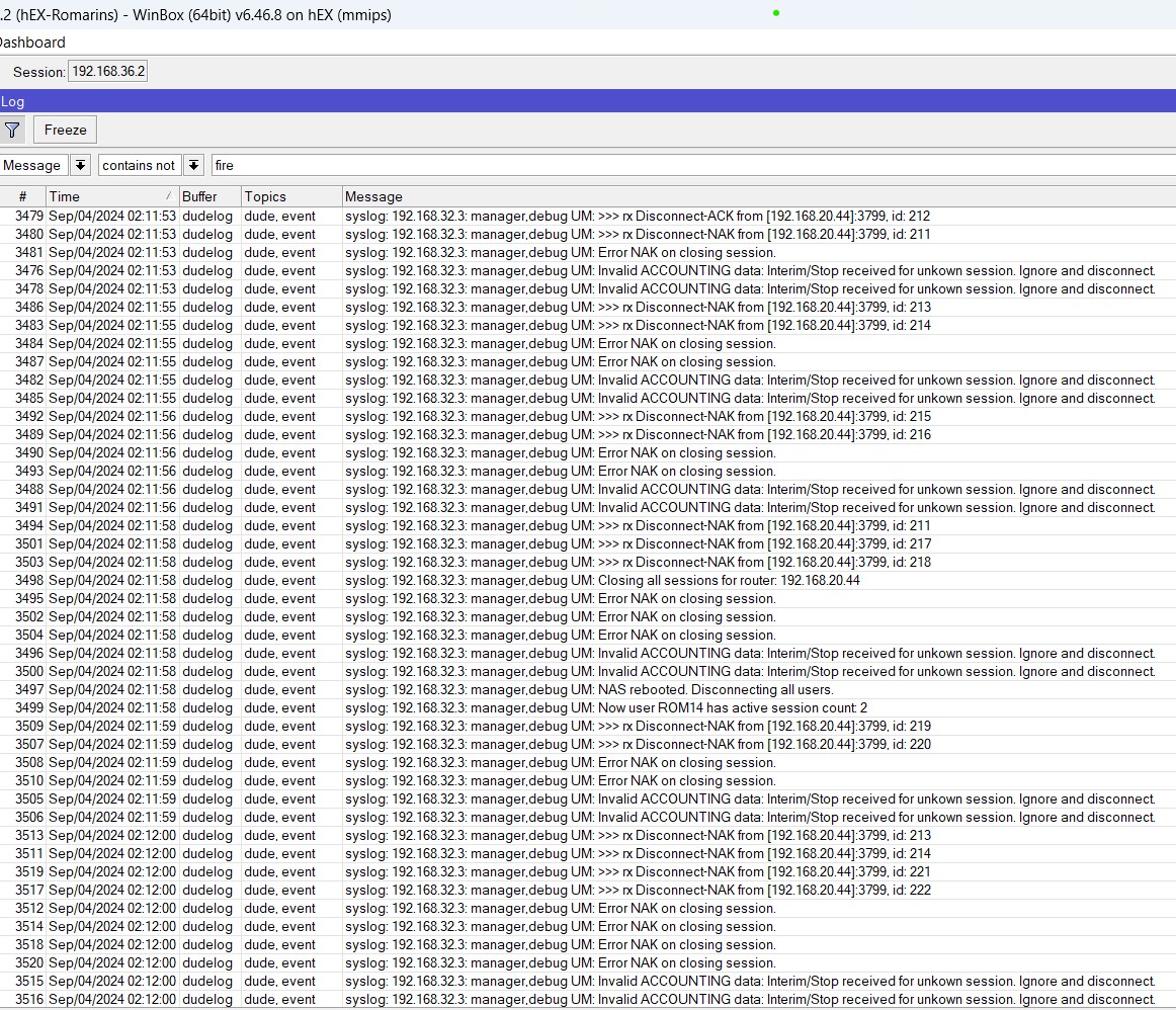

User MAnager claims NAS rebooted, from then on, for all sessions that are still there and do send intermediate accounting to User Manager
User manager in multiple attempts tries to disconnect that wireless connection, but the hAP just refuses to do it.

Still this is only happening, and even frequently this evening on just hAP14 (one of the 21 hAP ac2 with the same configuration, and in the same campus network)

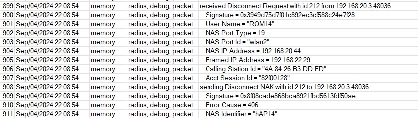

Getting closer to the root cause? “too strong signal” … never seen before
Eventually leading to something with error-cause=406 , only on that spot? I don’t see the relation with the disconnect request, unless the "too strong signa"l broke the PEAP sequence.
The request came from UM indeed.

Error cause 406 .=. “unsupported extension” See: http://forum.mikrotik.com/t/406-error-when-sending-disconnect-request-to-dhcp-radius/141221/1
Not supported … must use “Unsolicited messages” … but then why is MT User Manager not doing that? https://help.mikrotik.com/docs/display/ROS/RADIUS
