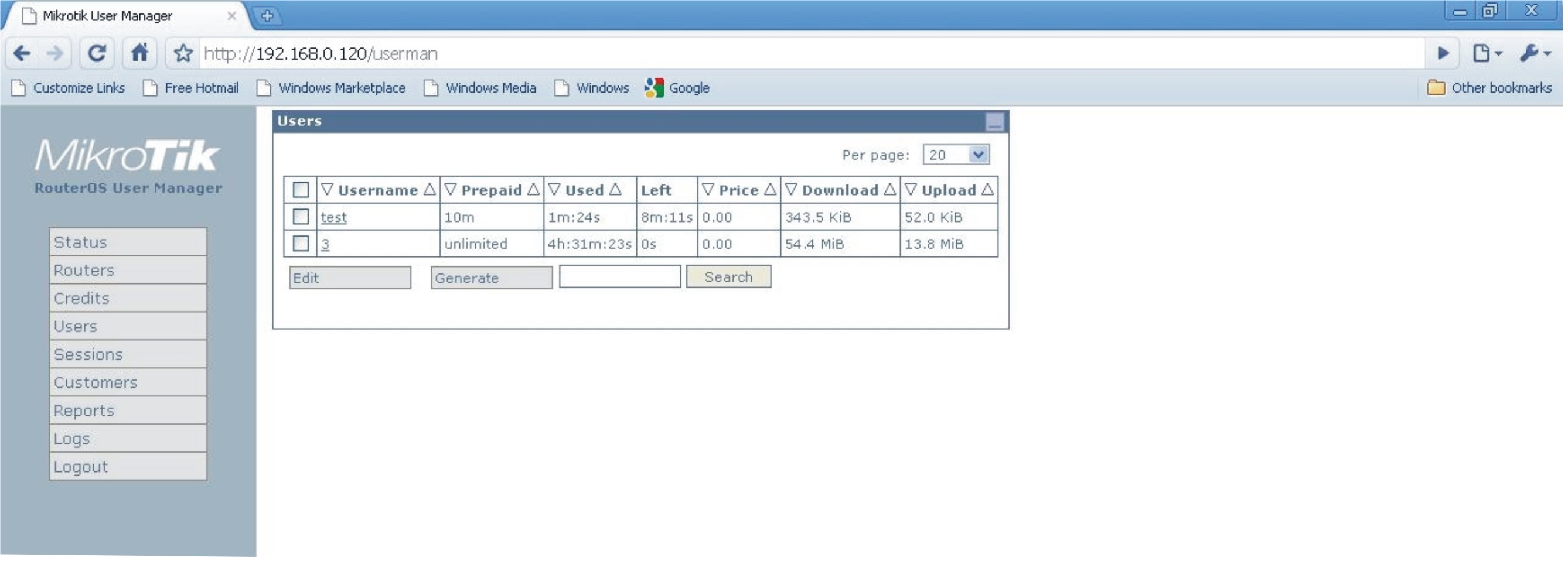

l login to my userman (192.168.0.120/userman) from there you can create user accounts. Please find attached image below:
