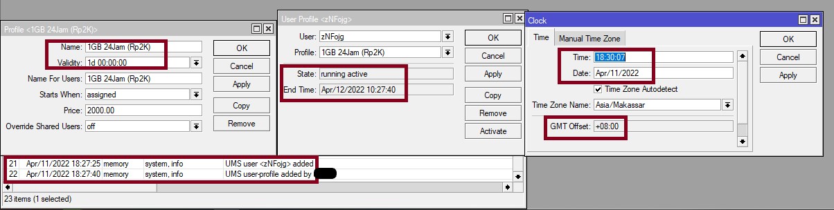

As seen at the snip-shot I take, I create a hotspot user using the New User Manager (ROS 7.2).
The problem is, exact time show when I activate the user-profile for the user is always -8 hours from the actual time it was activated.
Ex like at the shot, log say activate at 18:27 (match with /system clock at that time).
But the status at user-profile ‘running-active’ say will end at ‘tomorrow 10:27’.
How come, since I set the validity is 1d? It should be end at 'tomorrow 18:27, right?
I have test it yesterday, it just exact at 1d validity. So it must be just error shown. But it really annoying. It must be related to GMT Offset +8:00.
Please fix it guys. Thx in advance.

I’ve seen your post and it’s another thing. Plus I already check that Use Profile Usermanager Setting.
My problem is incorrect time only for showing, but the real data correct.
Like user profile created and seen at log at today at 18:27 for 24h validity - match with exact time /system clock (real clock)
But when we check at End time its not 18:27 tomorrow, but 10:27 tomorrow. But when the 10:27 (tomorrow, real clock) come, the user will not be disconnect.
At 18:27 (tomorrow, real clock) then the user will be disconnect. Validity set for 24hours working fine.
It’s just data ‘End Time’ show that missmatch with real clock. Still it’s annoying :smiley:

What’s new in 7.3beta33 (2022-Apr-11 14:09):
*) winbox - take into account timezone for timed values under “User Manager” menu;
Hope this will fix about my problem…
