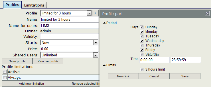

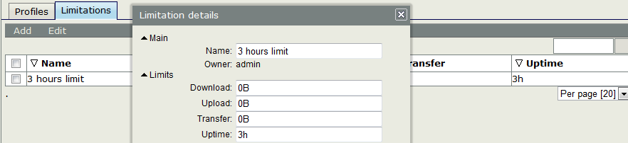

I’m trying to make a limit for 3 hours - have config a limit and put it in the profile of the user ,but it’s doesn’t work
what did I did wrong?

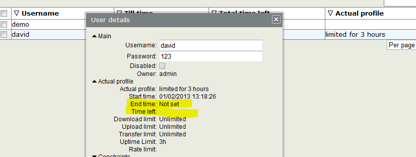

but now my problem is that I don’t see in the user-manager how much time left for that user

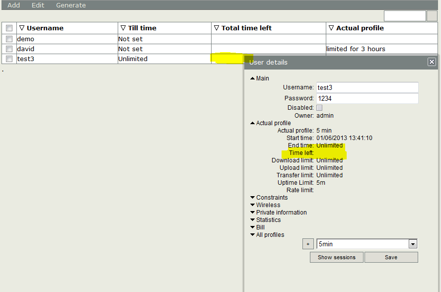

here is a img for the user-manager (I can’t tell how much time left for him)
