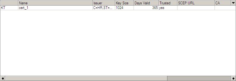

Yes I have certificate …
 /certificate> print
Flags: K - private-key, D - dsa, L - crl, C - smart-card-key, A - authority,
I - issued, R - revoked, E - expired, T - trusted
 #          NAME   COM.. SUBJECT-ALT-NAME                                   FIN..
 0 K      T cert_1 cen.. email:admin@mydomain.com                                90e..
with https://yourrouterip also dont work
only with http://yourrouterip work

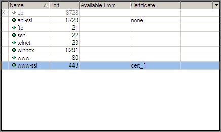

i guess you need to activate the HTTPS in the /Services Ports
give it a shot and let us know :wink:
No …
see on images:
I have the same problem, I used Ubuntu OpenSSL because the creation via ROS didn’t work for me (gave me error in the line sign template=ca-template ca-crl-host=x.x.x.x name=myCa from this manual http://wiki.mikrotik.com/wiki/Manual:Create_Certificates )
I imported everything but I also get flags KT, not KR as shown in the manual and the https page isn’t working for me either.

Solved !
When enable and disable service it was start to work … but
