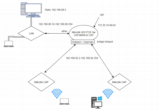

I already have separate interfaces for hotspot and LAN devices. LAN is in the IP pool 192.168.88.0, while hotspot is under 192.168.92.0. But the traffic between these two interfaces is still treated as thought user is using www internet, hence userman quota is running out much faster
Maybe a network diagram and post contents

Here is a network diagram
And export rsc file - https://paste.ubuntu.com/p/S9Xw3jgthW/
Ok, really you have 2 LAN segments and the same applies! You would have to separate the 192.168.92.0/24 from the Hotspot by using a separate device for the Hotspot or possibly by (I have not tested) moving the Hotspot to a separate bridge and use mangle/routing marks to send the desired traffic through the Hotspot bridge.

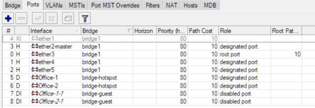

Oh, can you please help me to break it down to understand better?
If i understand correctly, in my setup, I have two bridges:
bridge-hotspot = the bridge where hotspot is implemented
bridge1 = a bridge of all 5 router’s ethernet sockets
By adding them all to Bridge/Ports I have made them all bridged together, so all the connected devices could ping(see) each other, no matter under which network they are.
And I have two DHCP servers:
LAN dhcp on bridge1
Hotspot dhcp on bridge-hotspot
What currently happens, is that the traffic between devices on LAN dhcp and Hotspot dhcp is seen as traffic and get’s subtracted from Hotspot Userman’s traffic quota. And I am somehow trying to make it don’t count any exchanged packages between LAN dhcp devices and Hotspot devices as Userman’s traffic.
You will have to add a second Mikrotik device between your current one and your ISP modem. You would then move your Hotspot and Firewall rules to this new device. Would need either 2 bridges, 1 for Hotspot and 1 for non-Hotspot or use 1 bridge for Hotspot and use IP Binding/ Bypass to allow you non-Hotspot traffic through.
Your current device would only handle CAPS, DHCP, and routing between the 2 Network segments. You would remove the default firewall and NAT as this would be handled by the new device.
I thought I had seen someone do something similar on a single device, but I could not find the post. And in my testing I was unable to get this to work.
