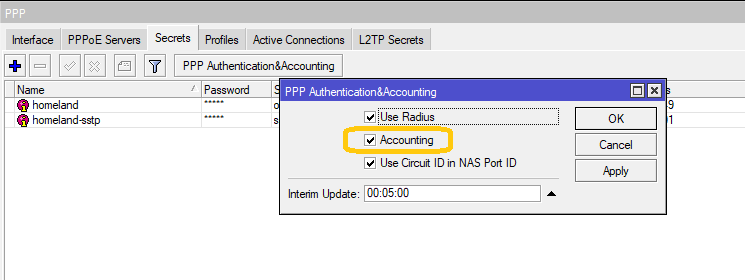

So you should search in your configuration for that accounting-part. It has to be enabled. (the pic is only an example … inside your hotsspot config, you should be able to find a similiar item.
… … something like “send interim update” ? … enable that tickbox ! … for further debug post an:
