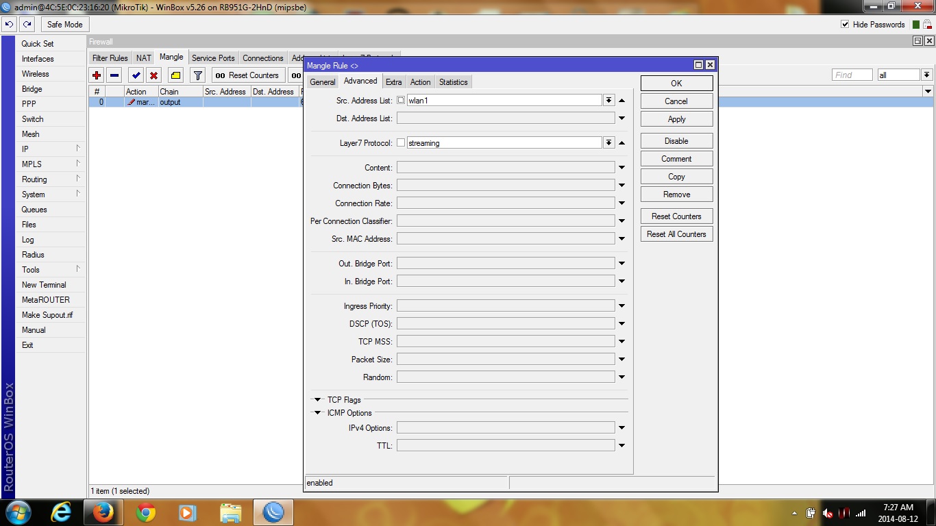

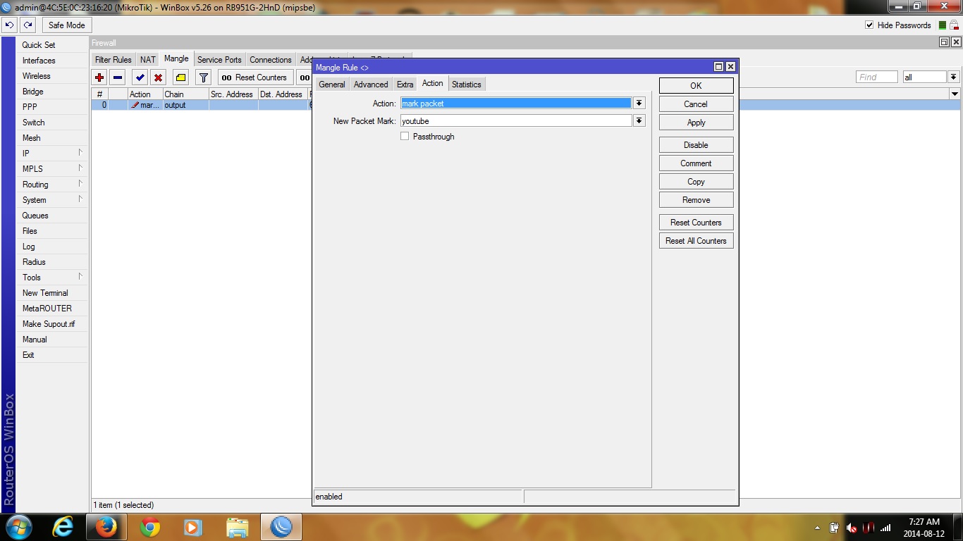

First i have created hotspot and users with 64k internet speed and unlimited data. Then i have added these code and after that i have tested the hotspot in my laptop. While using internet it works fine according to the limit but not good for youtube.
/ip firewall layer7-protocol
add name=streaming regexp=videoplayback|video
/ip firewall mangle
add action=mark-connection chain=prerouting comment="Youtube_ Client" disabled=no layer7-protocol=streaming new-connection-mark=youtube passthrough=no src-address-list=wlan1
add action=mark-packet chain=output connection-mark=youtube disabled=no new-packet-mark=youtube passthrough=no protocol=tcp

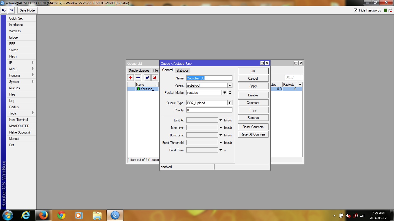

/queue type
add kind=pcq name=PCQ_Upload pcq-burst-rate=0 pcq-burst-threshold=0 pcq-burst-time=10s pcq-classifier=src-address pcq-dst-address-mask=32 pcq-dst-address6-mask=64 pcq-limit=50 pcq-rate=1024k pcq-src-address-mask=32 pcq-src-address6-mask=64 pcq-total-limit=2000
/queue tree
add burst-limit=0 burst-threshold=0 burst-time=0s disabled=no limit-at=0 max-limit=0 name=Youtube_Up packet-mark=youtube parent=global-out priority=8 queue=PCQ_Upload

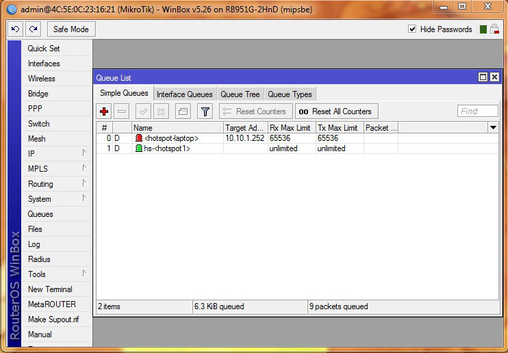

After this i login to my laptop. i can only see simple queue not queue tree… is it not working because its not in queue tree…

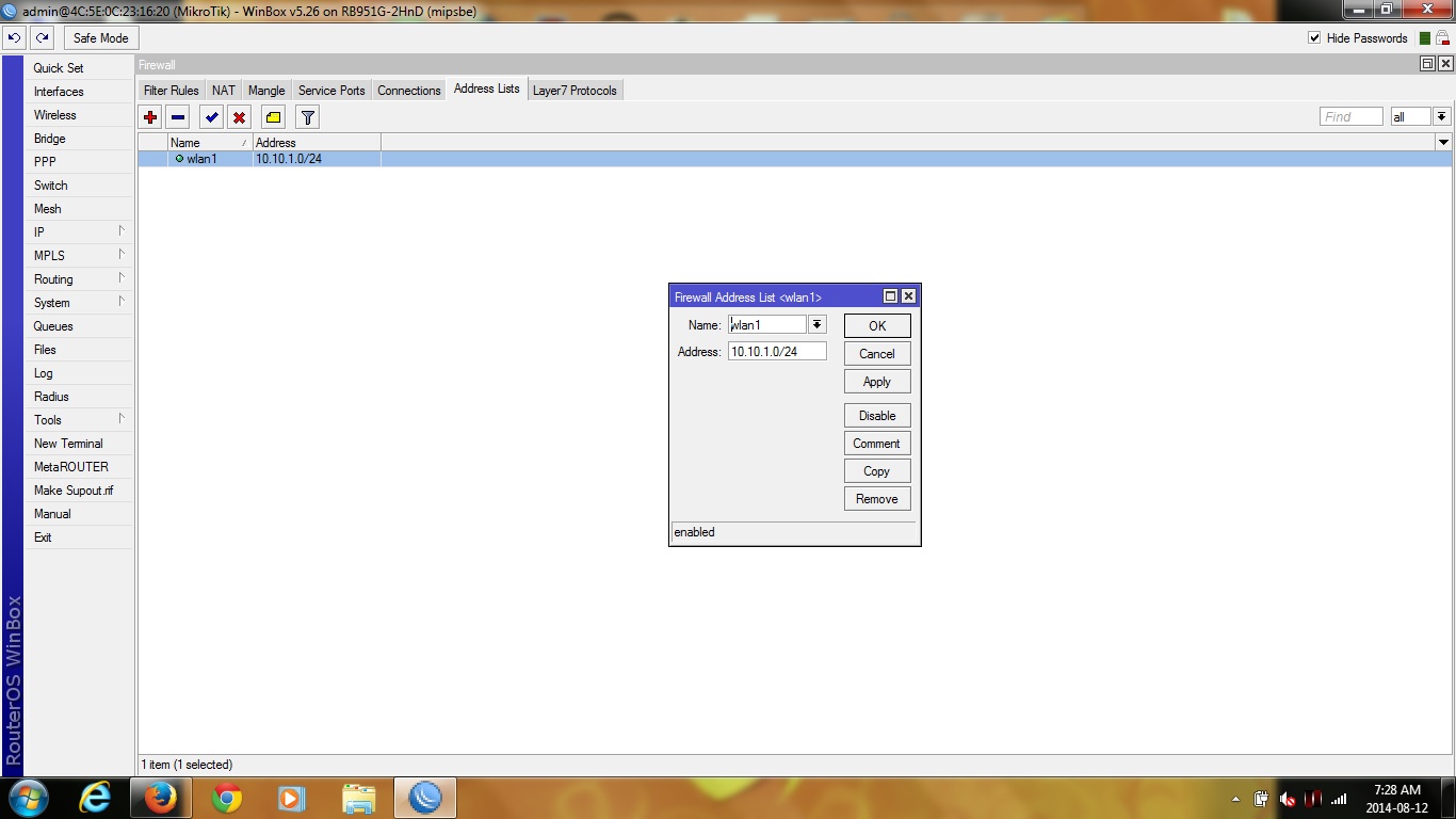

i have also added
/ip firewall address-list
add address=10.10.1.1/24 disabled=no list=wlan1
Are your mangle rules counting packets. If so, see on Queue Tree Tab, there should be Youtube_up with average rate around 1mbps when browsing youtube.

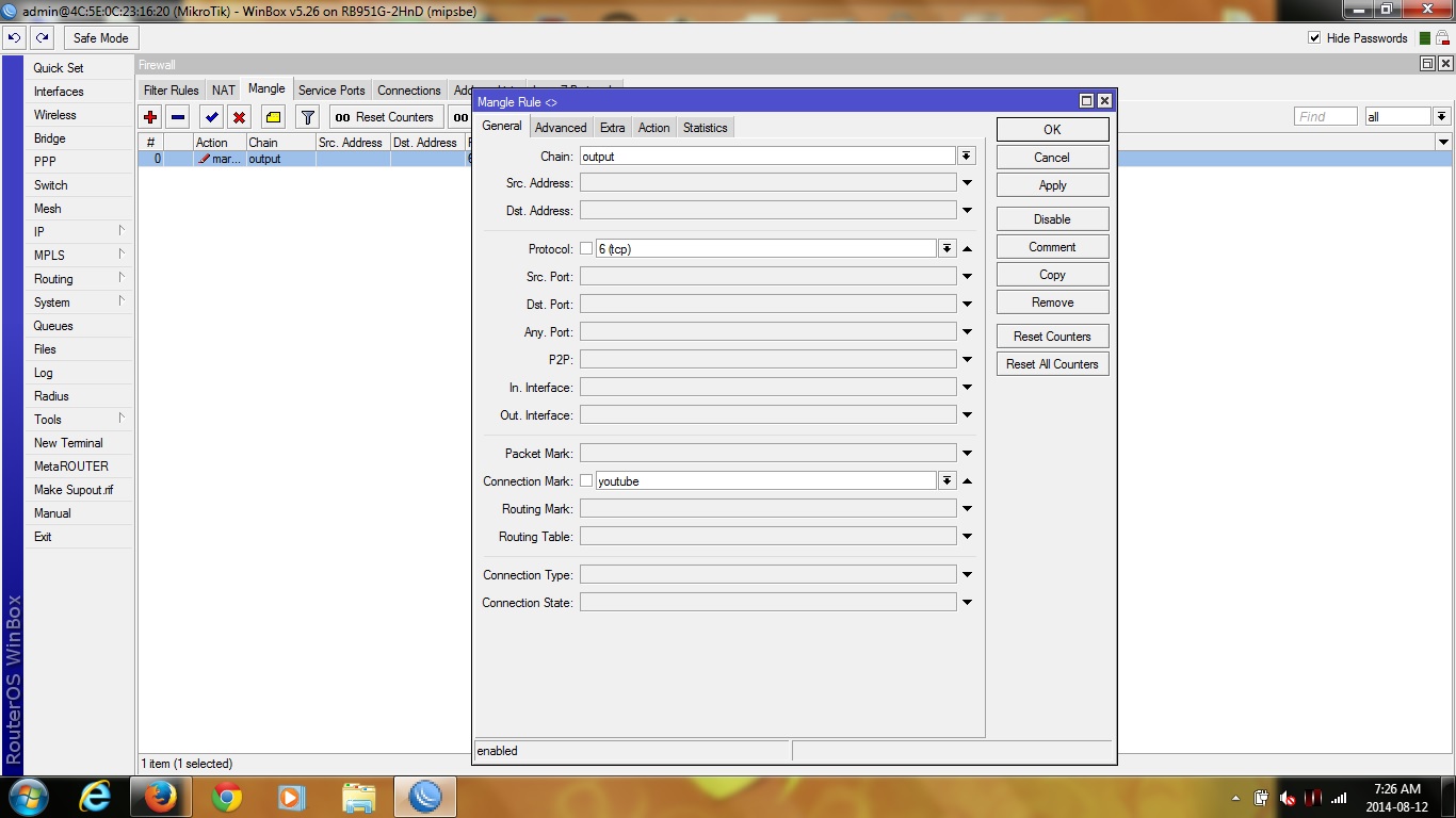

IP Firewall Mangle Rule

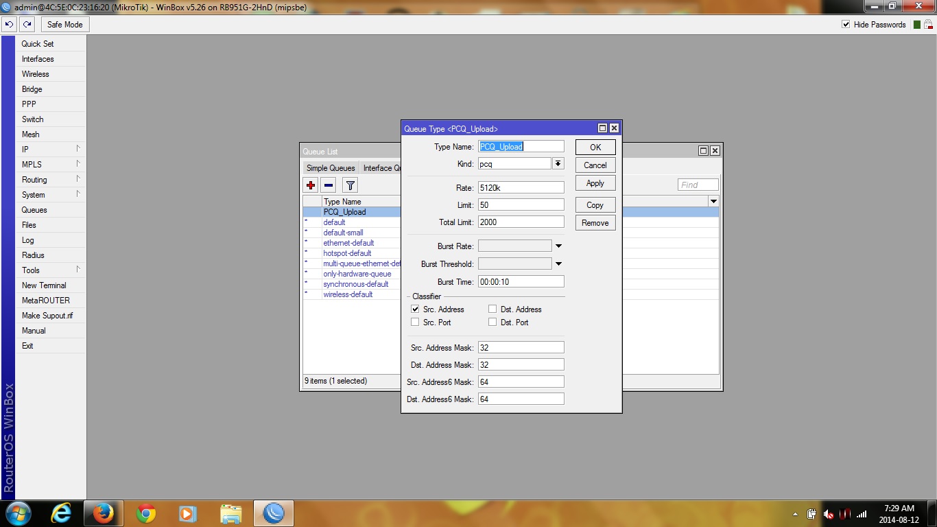

Queue Tree And Queue Type
Ummm everything seems fine but still i could not get it… am i missing something???
Where is the “mark-connection” rule in mangle?
Try the below code removing your existing rule.
add action=mark-connection chain=prerouting comment="Youtube" \
    disabled=no layer7-protocol=streaming new-connection-mark=youtube \
add action=mark-packet chain=output connection-mark=youtube disabled=no \
Your mangle rule should be in forward chain, not output.
