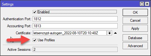

You should enable using the profile first. After initiating the first connection, the user profile will show the correct time.
Is this problem solved?

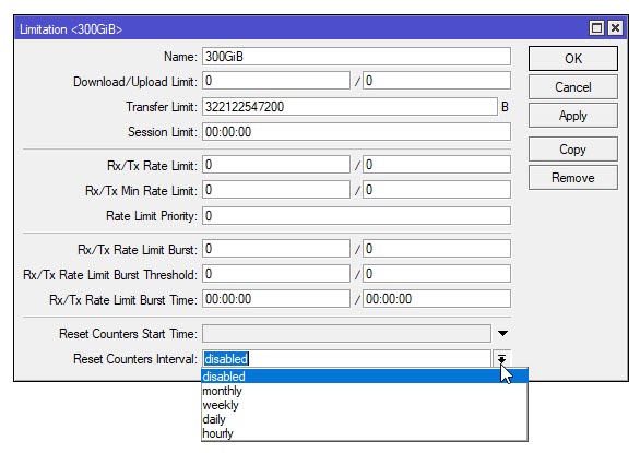

Unfortunately, in addition to this, there is also the problem of resetting users’ traffic after a certain period, which cannot be solved!
“resetting users’ traffic after a certain period” did you try this?
Exactly this method does not work and it does not reset in a specified time period
dont work!!!
The profile and start time work fine for me. You should check your initiated config. I didn’t use the limitation reset, so I can’t confirm your findings.
