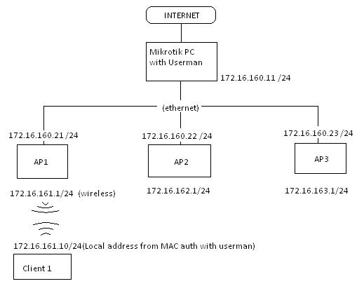

What i have:
1 Central server with Routeros + User Manager installed
6 Wireless Access Points connecting to the Server through ethernet cables
What i want:
-Clients must be mac-authed on central server (got this to work so far)
-Clients must get dhcp route to internet which routes through server (got this to work so far)
or they must pppoe in to authenticate with server (think i can get this to work)
-Clients must be limited to a certain speed(kbps) when accessing internet through server and also limited to a certain usage(kb), but must be unlimited on the internal network for file transfers etc… <<<<<<<<-------------------
How does usermanager see what i want limited to a certain speed and usage, and what i dont want limited. Im familiar with routeros but not usermanager. How can i get the limits on only internet access(external) and not local(internal)??

I’ve got usermanager limiting perfectly now. User connects and authenticates with usermanager to get one Ip address which is local ip address. He then dials a pppoe connection to usermanager to get another Ip address. the second address is allowed internet acesss.
The only problem is now if the client connects the pppoe connection, whenever he accesses local IP’s, it is counting towards his cap on usermanager and also he is rate limited locally. Is this “2 IP” method feasible? is there a way for local traffic not to count towards cap? ( the client can disconnect the pppoe connection temporarily to usage local network, but this isnt really the clients job but the WISP)

The above layout is what i currently have (without PPPOE). What you described is exactly what i want to achieve.
-The only difference is on my network a user which is connected to AP1 (172.16.161.x) should
be able to connect to a user connected to AP2 (172.16.162.x). so there is already a gateway
at 172.16.161.x for example. I don’t know if this will conflict with the setup.
-I think the problem with my setup is, I don’t know what to make the PPPOE ip range. Say for example i make it a range of pools from 172.16.180.0/24. then what should the gateway be? still 172.16.161.1? or should it be the Userman/Mikrotik server-pc (172.16.160.11)?
