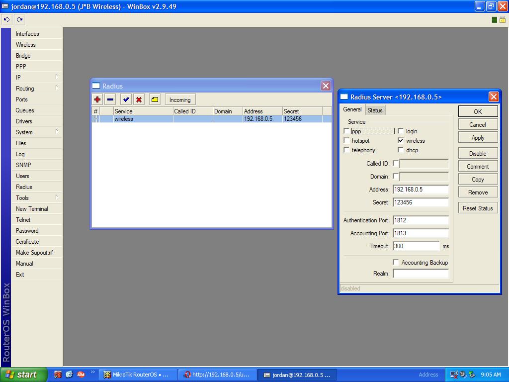

/ radius
add service=wireless called-id="" domain="" address=192.168.0.5
secret="123456" authentication-port=1812 accounting-port=1813
timeout=300ms accounting-backup=no realm="" comment="" disabled=no

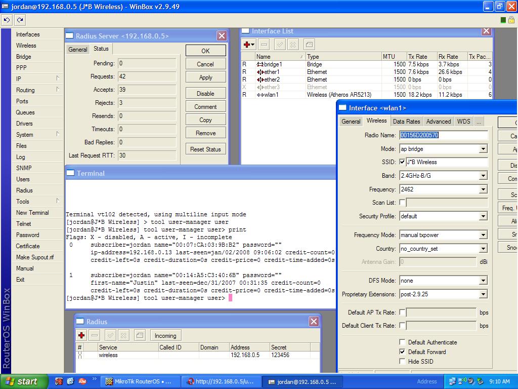

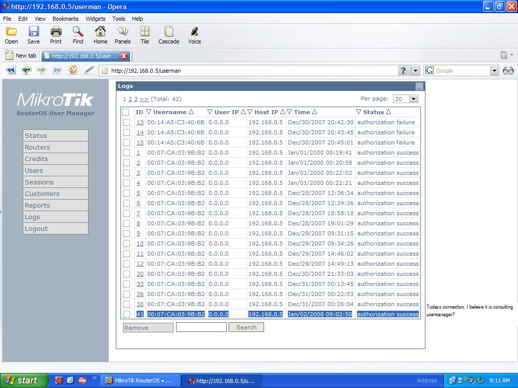

There it is!

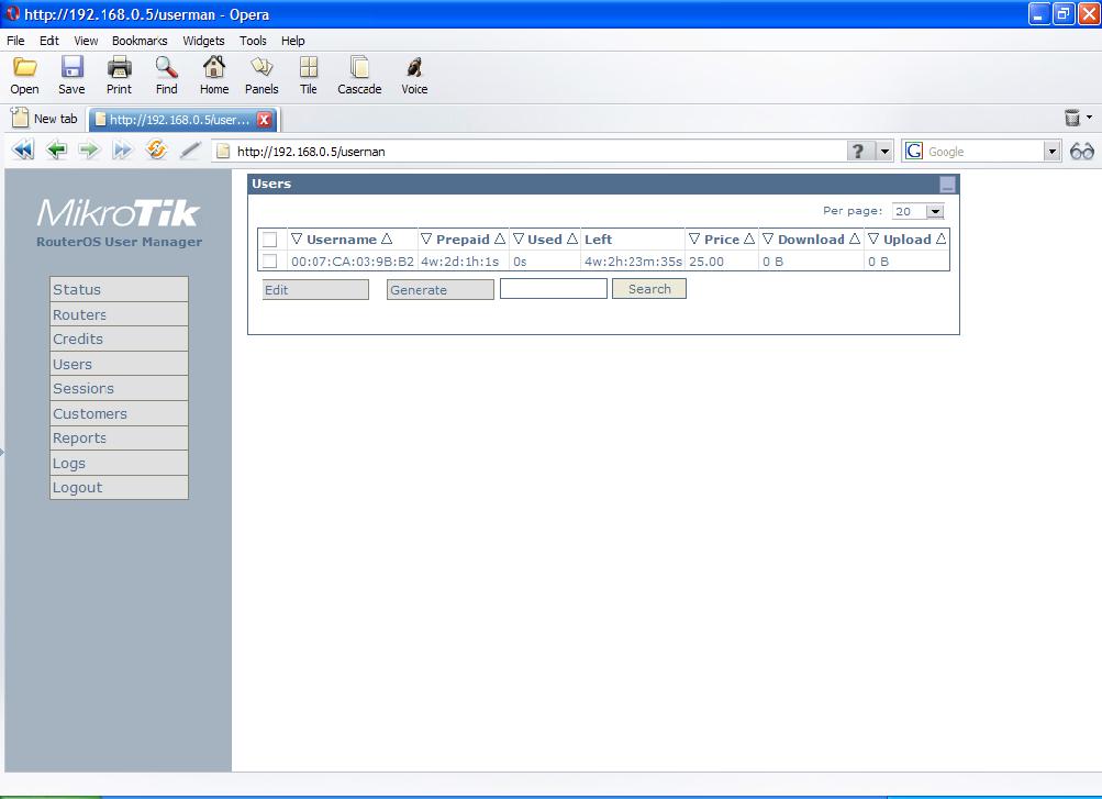

If you look in the third picture it shows the prepaid amount 4w2d1h1s in the left amount it has 4w2h23m35s But does not show the amount used... Just another thing i thought i should point out.... -Jordan

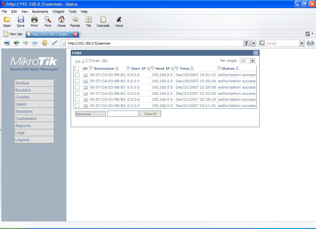

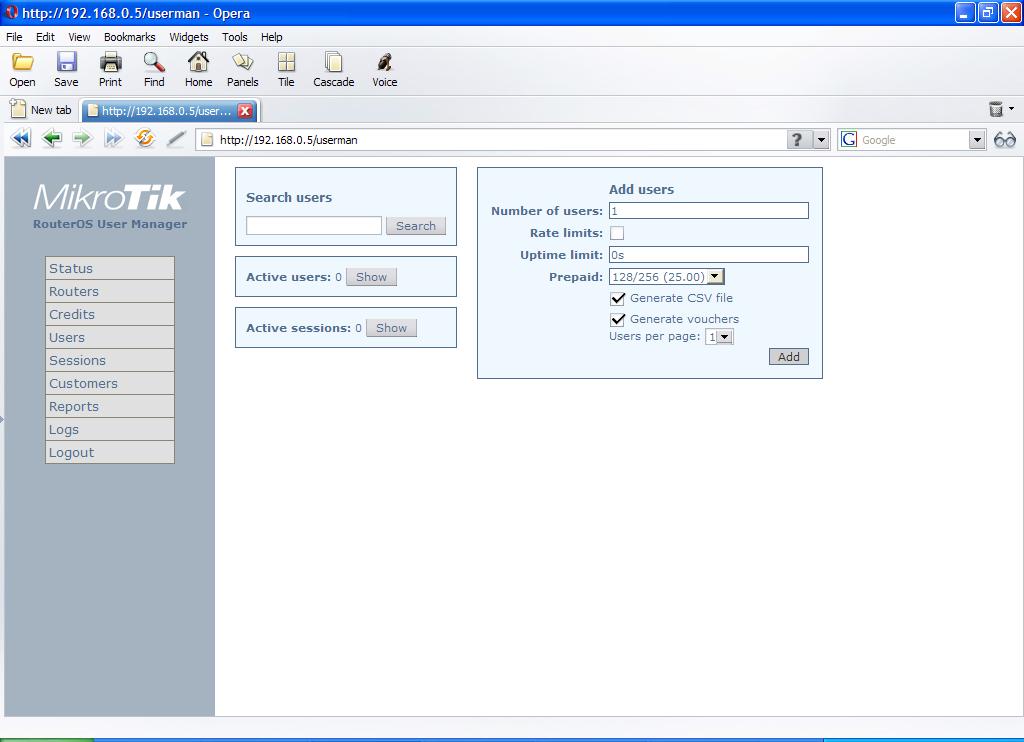

Here is more pics, there worth a thousand words so maybe thes can help you…
If there is ANYTHING you need extra let me know and ill post it here.. thanks sergejs -Jordan

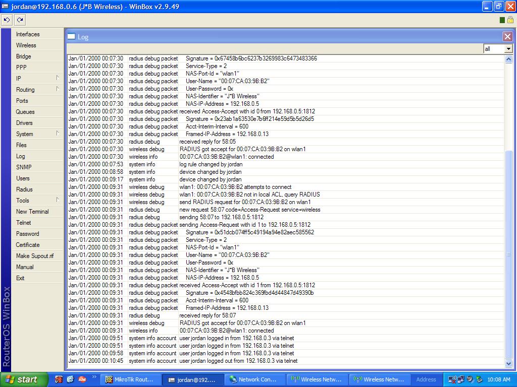

Enable ‘radius,debug’ logs, post the results here (enabled/disable wireless interface and force user to re-authenticate).
Here it is, in a picture, i didnt know how to use telnet to get log data… -Jordan

Radius export
[jordan@J
B Wireless] > radius export
jan/01/2000 05:00:47 by RouterOS 3.0rc13
software id = UZ4E-FTT
/radius
add accounting-backup=no accounting-port=1813 address=192.168.0.6
authentication-port=1812 called-id="" comment="" disabled=no domain=""
realm="" secret="123456" service=wireless timeout=300ms
/radius incoming
set accept=yes port=1700
[jordan@J*B Wireless] >
I REALLY need a working user-manager for my network and its realllly slowing down any progress of me gettting going..... thanks guys .......
jordantrx,
ok, wireless clients are not shown in status, because there is no accounting information, User-Manager is being used only for wireless client authentication (information is shown in logs).
You may try and disable ‘radius-mac-authentication’ at the security profile, then client will not be able to authenticate, as RADIUS will not be used and he/she is not included into local access-list.
That did it!!! its working now, i cant finally use it! and the automated billing script! thanks sergejs, much appreciated!! -Jordan
