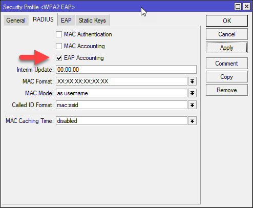

NOW, ALL clients can auth but, usermanager doesn’t show any active sessions ?!!?

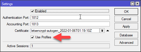

radius-eap-accounting=no
This should be set to "yes".

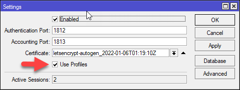

do you use profiles in user-man?

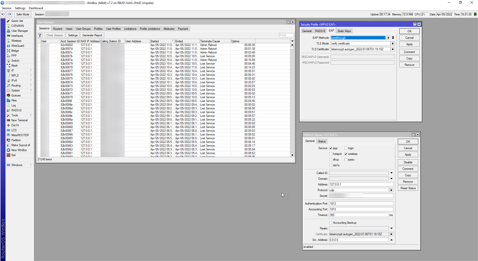

However, have any idea how to force close sessions with “not active” status as it seems that sessions now is flooded by this type of sessions( can’t close them)
I’m no expert and all of these are assumptions.
To me looks like the user-man is not aware of the latest status of the connection.
You have a different AP so maybe you should use CAPsMAN. (Does the main router have a Wifi interface? so that you can test and find out if the problem with the session is still there “NO AP” involved, everything runs locally.)

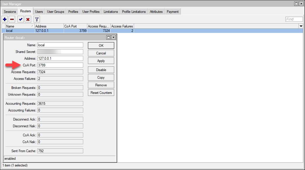

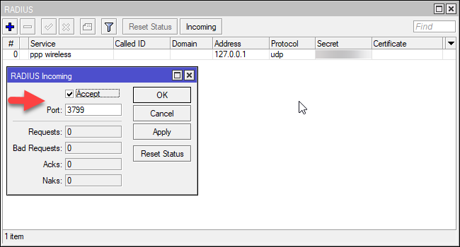

/ip firewall address-list
add address=127.0.0.1 list=RAS
add action=accept chain=input comment=RAS dst-address-list=RAS dst-port=1812,1813,3799 protocol=udp src-address-list=RAS
