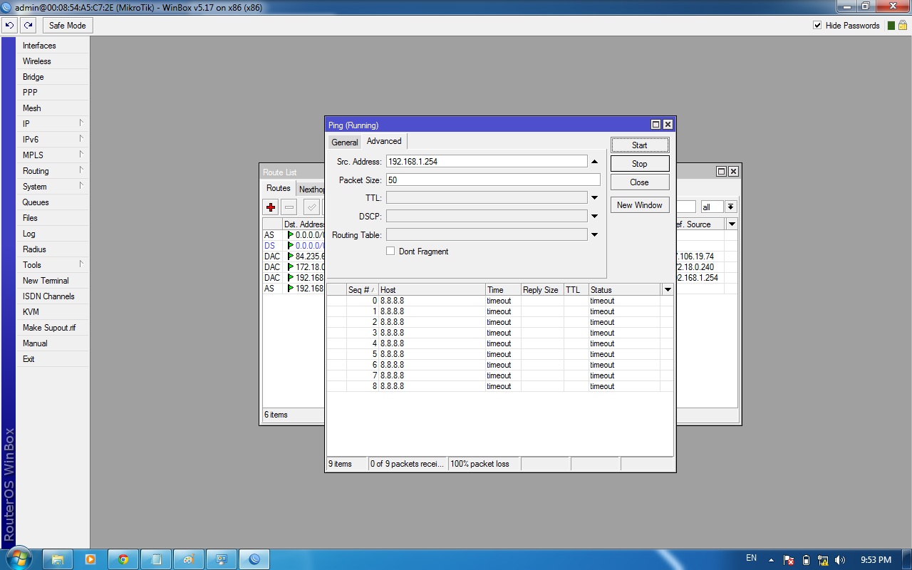

The ping still gives time-out even after adding the nat.

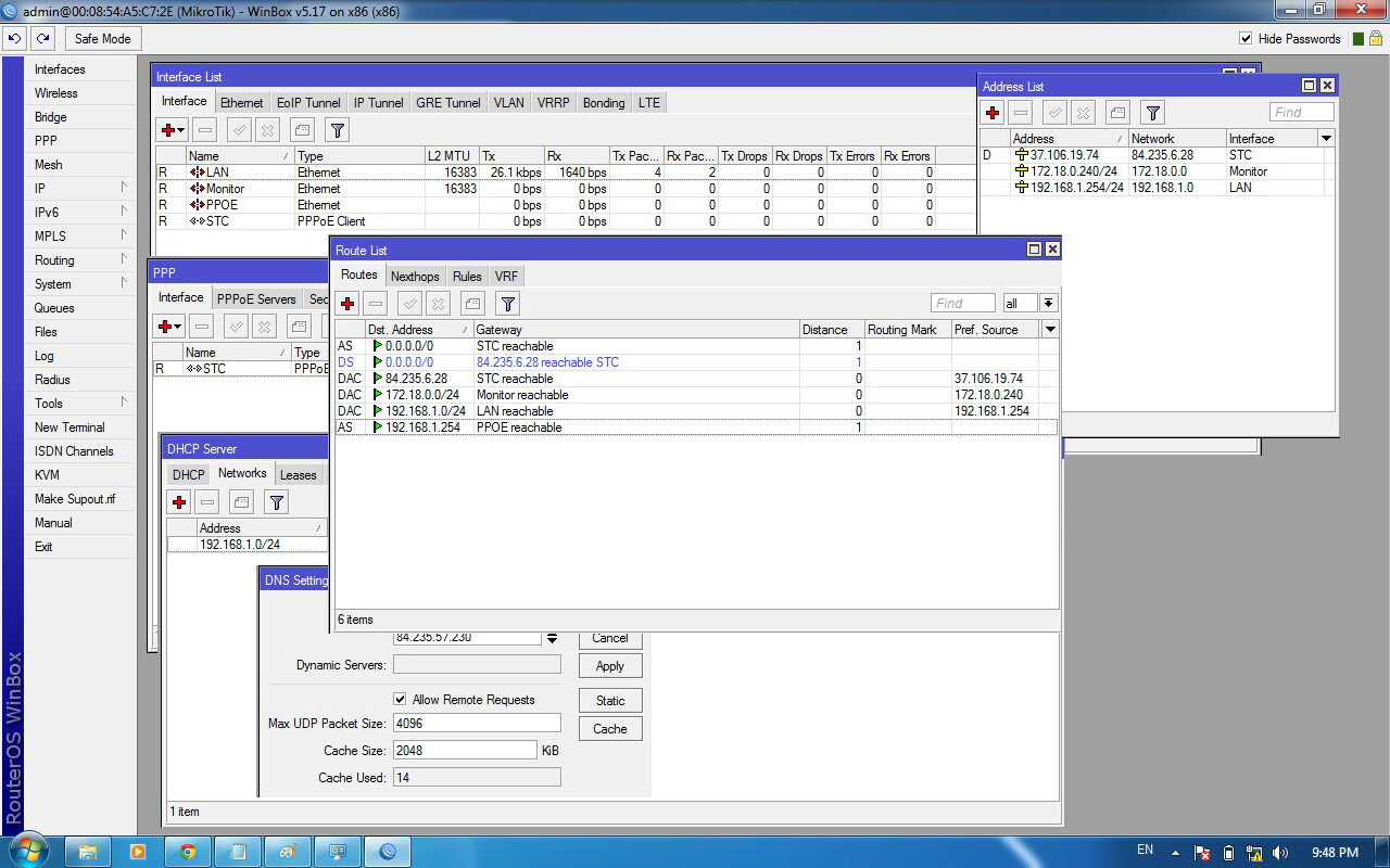

The range 192.168.1.0/24 is on the LAN interface so why is there this address assignment:
add distance=1 dst-address=192.168.1.254/32 gateway=PPOE?
Well, I’m not too sure why I gave that :confused:
Lemme change and see
I removed the route and yet there is no internet for the clients

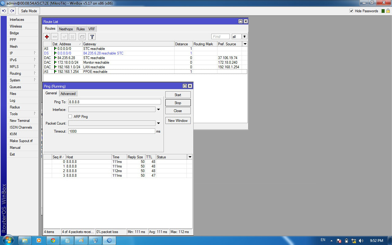

[admin@MikroTik] > ping 8.8.8.8
HOST                                     SIZE TTL TIME  STATUS
8.8.8.8                                    56  45 107ms
8.8.8.8                                    56  45 107ms
8.8.8.8                                    56  45 108ms
8.8.8.8                                    56  45 106ms

[admin@MikroTik] > ping 8.8.8.8 src-address=192.168.1.254
8.8.8.8                                                 timeout
8.8.8.8                                                 timeout
8.8.8.8                                                 timeout
8.8.8.8                                                 timeout
8.8.8.8                                                 timeout
8.8.8.8                                                 timeout
8.8.8.8                                                 timeout
8.8.8.8                                                 timeout
8.8.8.8                                                 timeout
8.8.8.8                                                 timeout
8.8.8.8                                                 timeout
8.8.8.8                                                 timeout
    sent=12 received=0 packet-loss=100%

Isn’t your default gateway 192.168.1.254? Why don’t I see that route?
add gateway=192.168.1.254
Or is it on the STC interface?
Yes, the default gateway for my LAN is 192.168.1.254. Let me add the route and see the output
Added
distance=1 add gateway=192.168.1.254
It only showed the ip unreachable. But I believe to what you asked as whether it is on the STC interface, the answer might be yes for that as add default route is checked in the PPPoE setting.
can you post your NAT settings?
i know mine wouldn’t work unless i added
/ip firewall nat add action=masquerade chain=srcnat disabled=no out-interface=STC
Thanks dboillot.
I had the firewall as this before
add action=masquerade chain=srcnat disabled=no out-interface=PPPoE \
    src-address=192.168.1.0/24
changed it to
All issues solved. Thank you all for helping me.
