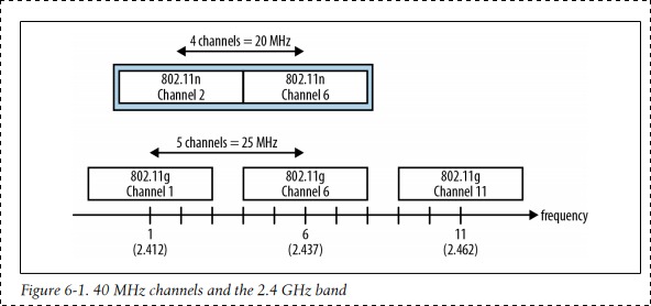

I go on and get the O'Reilley "802.11n: A Survival Guide" by Matthew S. Gast https://www.amazon.com/802-11n-Survival-Guide-Wi-Fi-Above-ebook-dp-B007R69HW2/dp/B007R69HW2/ref=mt_other?_encoding=UTF8&me=&qid=
Find the relevant sections and tell him:
Page 62:
In the 2.4 GHz band, however, there are no good choices for where to put a 40 MHz channel. Figure 6-1 shows the difficulties of enabling a 40 MHz channel in only 83 MHz of spectrum.
Page 63:
As a general rule, 40 MHz operation in 2.4 GHz is acceptable if there are no other networks in range.
Page 105:
Do not use 40 MHz channels in the 2.4 GHz band. With only 83 MHz of spectrum, you have space for just two, and that’s only if you ignore the overlap problems. Just don’t do it.

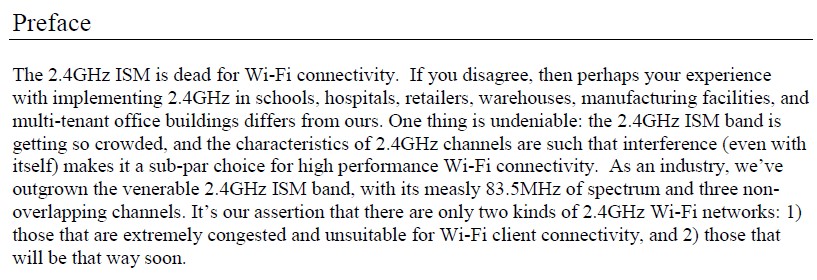

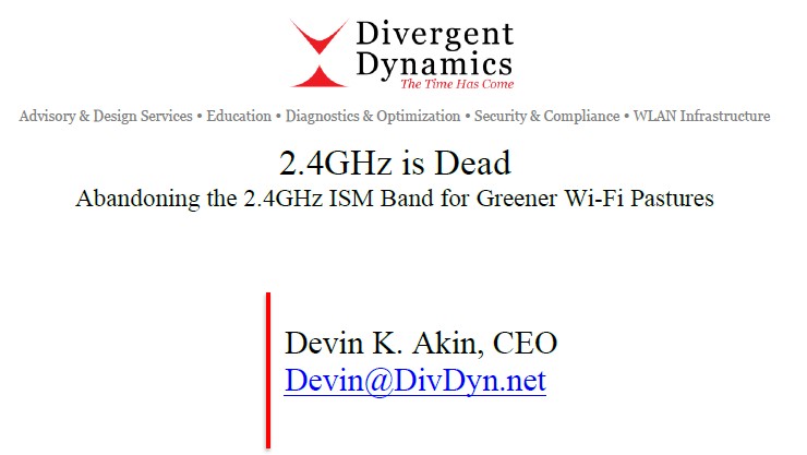

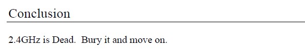

So it is not yes/no, right/wrong. It depends. But it is clearly time to move up to 5GHz !!
The old document “2.4GHz is dead” disappeared from the internet unfortunately, and its too big to attach here, but I can give the conclusion:
