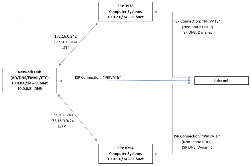

Did this on the fly let me know if it helps? I can clarify further.
Because the site 3978 and 8794 are dynamic. I have to disable use-peer-dns to allow the manually set DNS records to take effect. This gets me the desired outcome of having the system check my DNS servers for the appropriate records. But as soon as the router located at 3978/8794 reboots with those settings set to NO the system never recovers. Until they are turned back on and the system is rebooted again. I need to be able to establish the local DNS connection in a way that the routers can reboot and come back up successfully.

It’s better. As I understand it, the problem could be that L2TP client connects to hostname and when you reboot the router while it has 10.0.0.3 as DNS server, it can’t resolve it and can’t connect. And if ISP’s DNS is dynamic, you don’t know what address should netwatch set as DNS. Did I get it right?
If so, my first idea was to check DHCP lease script and hopefully there would be DNS address even with the peer DNS option disabled, but according to manual it’s not there at all. Another solution, even easier in fact, would be to temporarily use some public resolver (e.g. 8.8.8.8) if nothing better is available.
edit: Well, not really temporarily, because with peer DNS option disabled, you wouldn’t know what it is. But since 10.0.0.3 is supposed to be the main one, public resolver would be only a backup and I don’t see any problem using it.
I verbalized a very loud “duh” after reading your comment, thank you. The google DNS worked perfectly.
