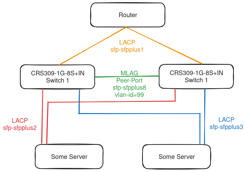

I’m new to Mikrotik devices and tried to get a working configuration for days.
I would like to use two CRS309-1G-8S+IN as Switches behind a router.
The switches should be in a HA setup with MLAG.
The connection to the router should be with with LACP as the connection to the client. The best description is probably this drawing:
At the moment I would like to use it without different VLANs.
