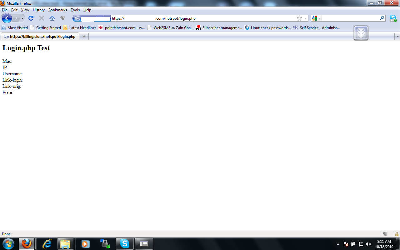

l did load the code and this is what i got
you can modify the default mikrotik login in pages for me.
When l get them working l can then edit that one.
Is it working when you try to login? I don’t see the output I expected. The link-login should be http://192.168.1.1/login (maybe not that ip) and the link-orig should be the site you were trying to load when the hotspot stopped you and sent the login page instead. The mac address and ip are not there either.
